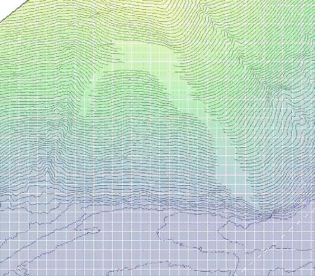

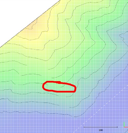

When I treat topography data, some iso-lignes are not continuous (see attached picture).
Bug CC.jpg (107.04 KiB) Viewed 4576 times
If I demand closer lines, it looks worse.
Bug CC2.jpg (120.03 KiB) Viewed 4576 times
The void pattern looks funny so I think it might be a problem in the algorithm...

Re: Contour in Rasterize non-continuous
Indeed this hole is quite strange... it's probably a bug of course. I would be very interested by your cloud indeed (and the parameters that would reproduce the bug if they are not the default ones). You can send it to me at 'cloudcompare [at] danielgm.net' (replace [at] by @).
The contour algorithm is not the same (at all). And I changed it recently so hopefully this second issue should be fixed by those modifications.
