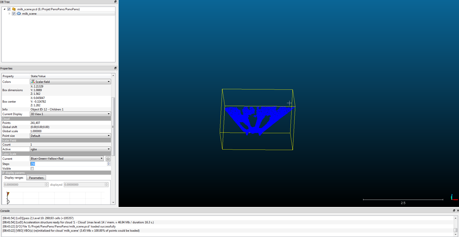

But, when I open the image that works with PCL in CC, it becomes all blue (cf expl2), and when I reexport it, colors had disappear :/
- The file that "works"
- expl2.png (55.56 KiB) Viewed 11423 times

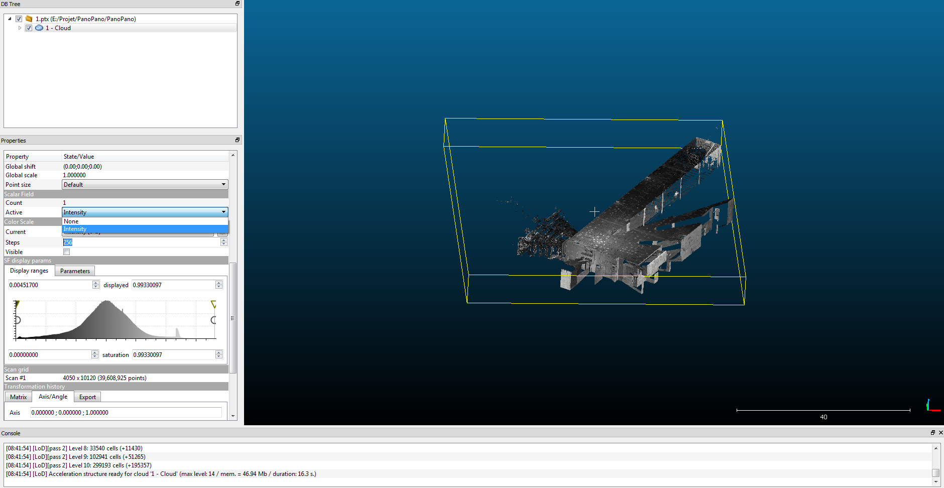

- The file I want to convert to RGBA
- expl1.png (143.04 KiB) Viewed 11423 times

Hum, the first cloud does have an 'rgba' scalar field, but it seems to be invalid?! Maybe the PCL importer failed. This would explain why you can't export it properly.
Can you send me corresponding file?
