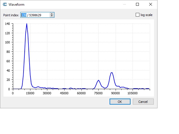

Oh, to load a file with FWF info, you have to load the files with the 'LAS 1.3 or 1.4 (*.las *.laz)' filter (otherwise the default LAS importer based on LibLAS is used).
But this is a development in progress. For now you'll only be able to see the waveforms (if any) associated to each point in a separate graph:
New options will appear at the end of the year (3D display, etc.).

@KG_WUT You have to select this filter in the 'Open file' dialog. Via the drop-down menu where you can select the file type.

You must use the 'LAS 1.3 or 1.4 (*.las *.laz)' filter (in the file opening dialog).
However you won't go very fare with the current version, as you'll only be able to visualize the waveform as a 2D curve in a separate dialog. All the good stuff will come later in a separate plugin.
