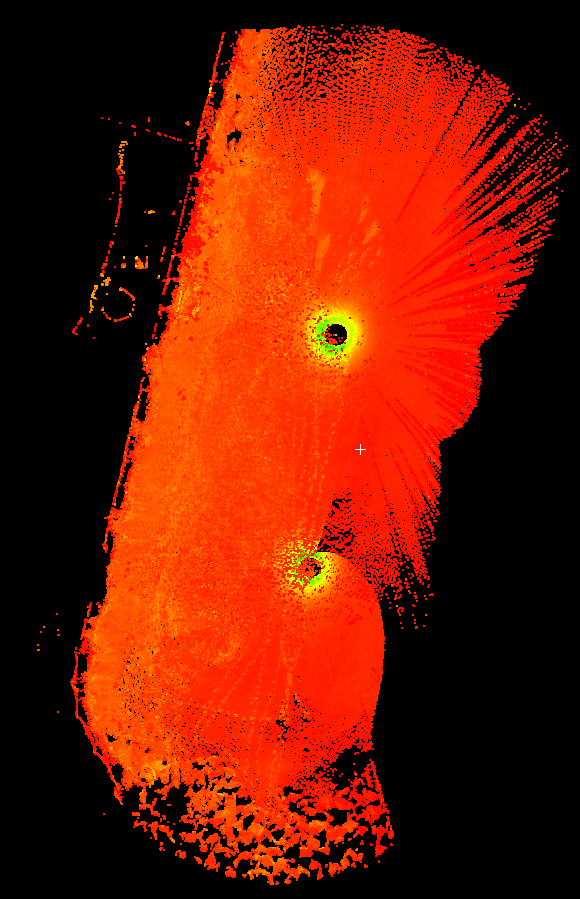

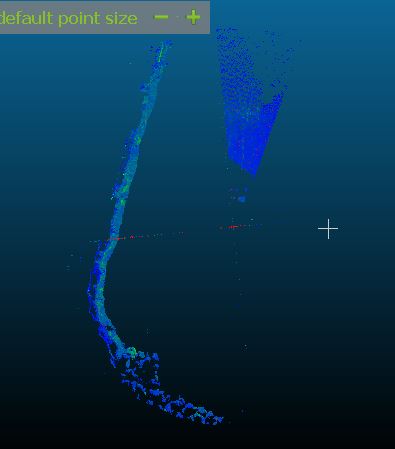

Also having issues importing .PTS files. (Using version 2.6.3). Only part of my clouds import successfully. Other points are missing, or scattered. I've attached an image of what the complete point cloud should look like, and how it's coming through in CC. The strange thing is that it has worked previously without any issues. As far as I can tell I'm not doing anything differently. Puzzled!
- Broken in CC
- CC.JPG (19.1 KiB) Viewed 6302 times
- Complete cloud
- cyclone.PNG (215 KiB) Viewed 6302 times
Re: Trouble importing files (Txt.,LAS,CSV..)
It's maybe an issue with the graphic card driver? (it doesn't display all the points?)
Anyway, as this version is very old, my only answer can be: use the latest version ;)
