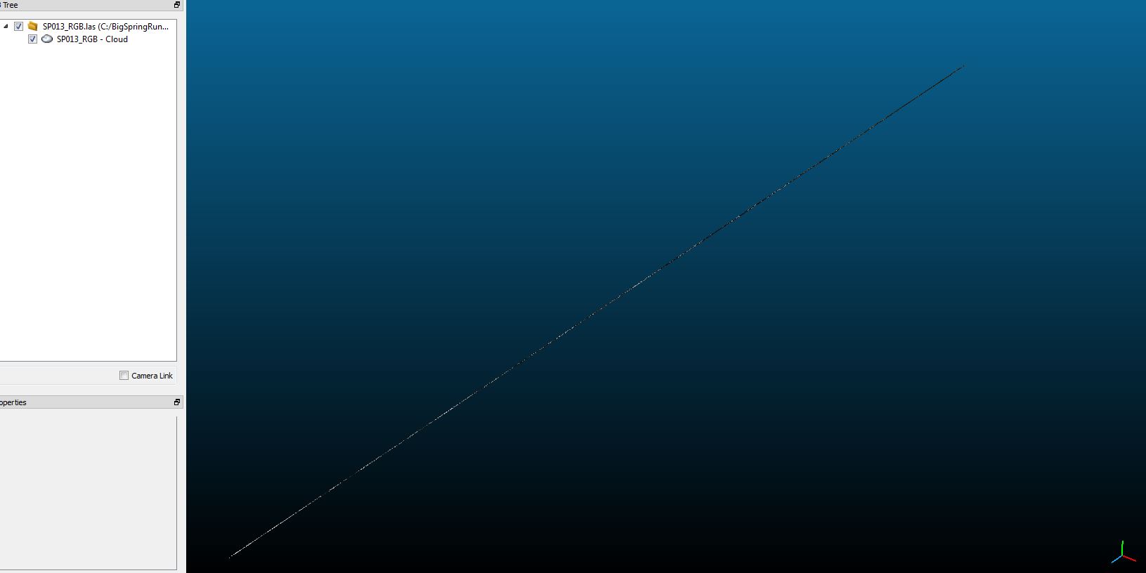

So this is my first time using CloudCompare and I'm having trouble with what should be the easiest part of the process, opening a compatible file. I've used these files with numerous other point cloud viewers and have done much analysis on them but am having trouble seeing these files when I upload them into CloudCompare.
I'm simply navigating to "Open" and selecting either a LAS file, TXT file, or CSV file (I've tried all three), and all I get in the viewer is a straight line of what looks to be a "smushed" linear point cloud. I get this result from everything I try to import.

Isn't there simply a scale issue along one of the axis? It looks like the Z values are much bigger than the others.

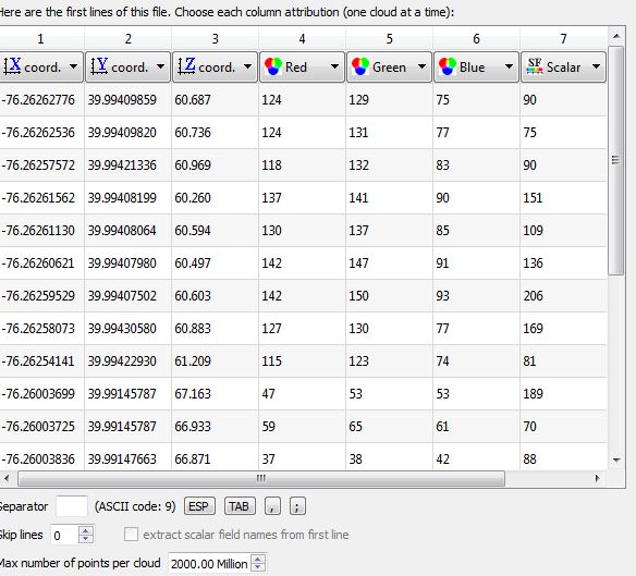

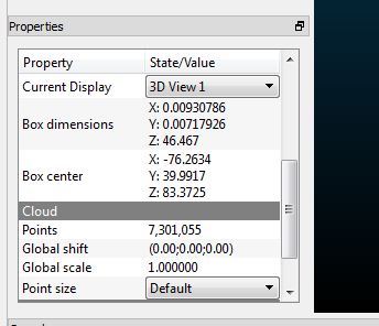

Thanks for the quick reply Daniel, I've attached an image of a text file that I've been having trouble importing. Also, the properties of the file which look strange to me...the XY box dimensions look small compare to Z..is this what you were thinking?
Re: Trouble importing files (Txt.,LAS,CSV..)
How strange. The X and Y dimensions are indeed squeezed once loaded. Does CC complains about big coordinates or something like that?

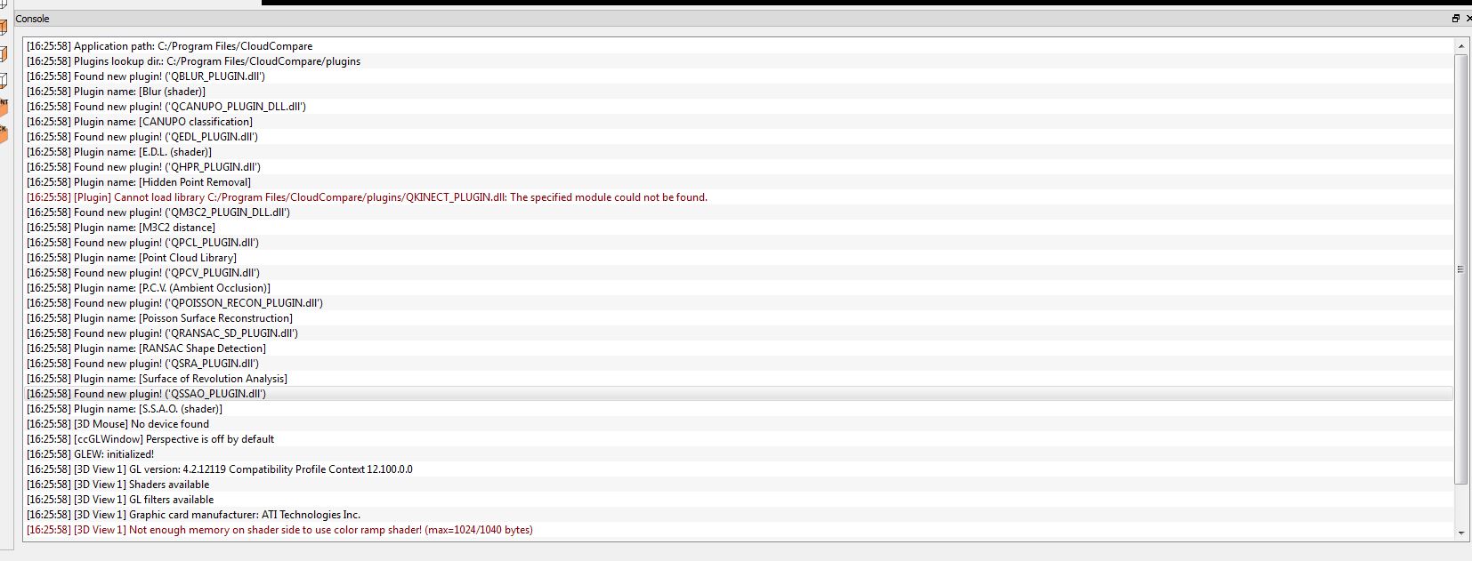

I believe I am using the latest version (2.5.4 64bit). I have noticed the following alerts in the console window. See image.
Nothing strange here... can you send me the file?

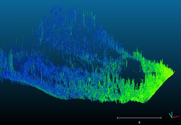

Ok, so I confirm that after looking at the file you sent me, the X and Y coordinates are about 10,000 times smaller than the Z dimension. The attached image is what I see if I multiply by 10,000 the coordinates before loading the cloud.
Not sure how they were generated (do you the respective units of each dimension?). I wonder also how other software manage to display this correctly?
You can rescale the X and Y dimension in CloudCompare after the file has been loaded (with 'Edit > Multiply/Scale') but it will be too late (you'll lose a lot of numerical precision).
