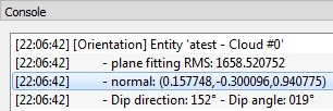

I was trying you suggestion with the dot product, but I was not sure which vector is the normal to the plane.
Is it the "Axis" vector?

When you fit a plane, you get its 'normal' in the Console:
It corresponds to the 3rd column of the "Transformation history" matrix.
