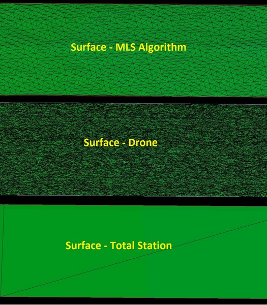

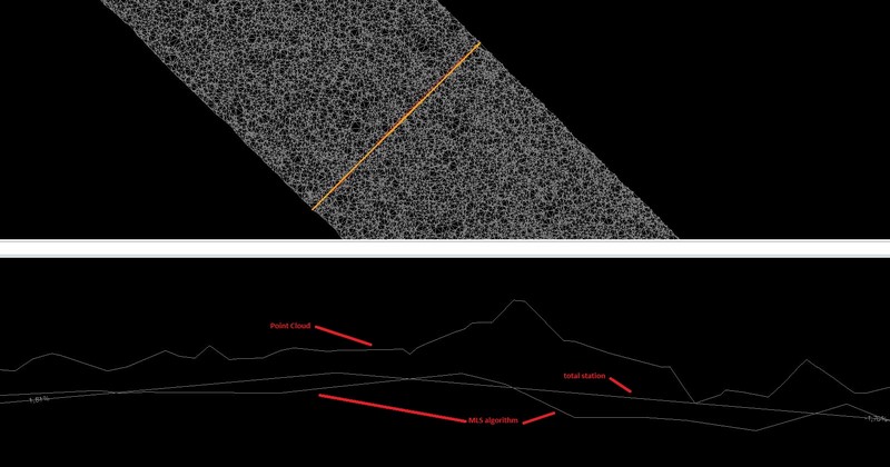

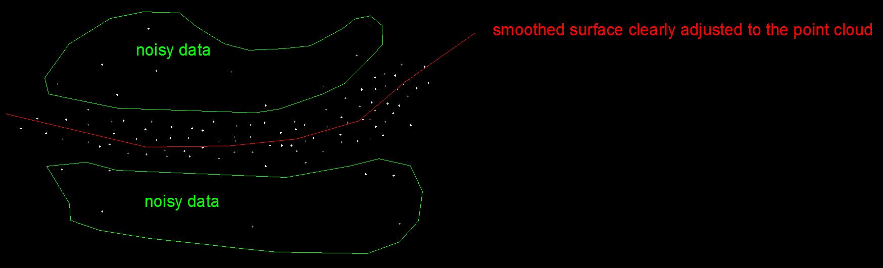

I would advise you to certain issue. I need to make an inventory of road using point clouds aquired by my drone. To processing my data I have to remove noisy scattered data points and get smoothed set of points in order to prepare proper point cloud to further process. As the result I need to reconstruct surface that is the best adjusted and approximated to the real road surface.
I have read about Moving Least Squares (MLS) surface reconstruction. It looks great but I have a doubt it distorts the model of the surface. Always when I use this method the final surface is slightly below the whole point cloud. But I need to adjust my surface to agglomeration of points (exclude noisy points).
I am attaching a image of example points to submit what I mean.
Thank you for any suggestion in this case.

You can try SOR (Statistical outlier removal) before MLS algorithm that would improve the quality of the surface.
