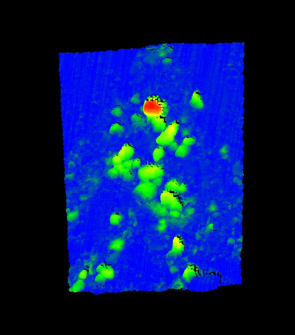

hello everybody,
I want rasterize a pointcloud which results from a comparison. Like that :
[img]

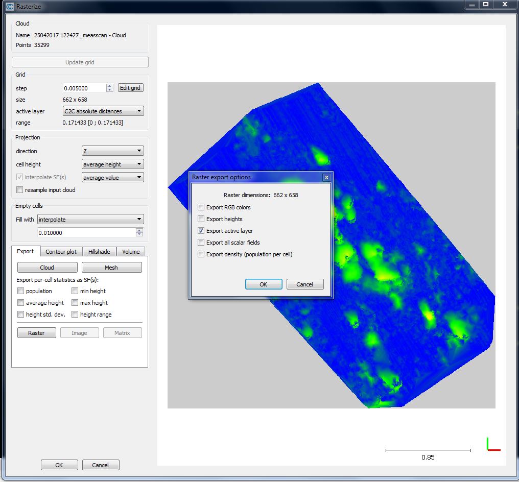

I do this programmation :
[img]
[/img]

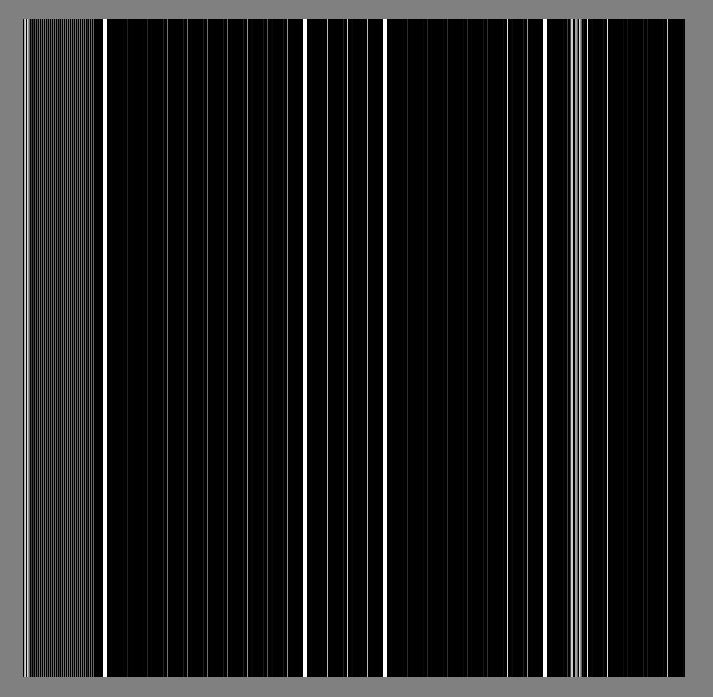

The result is this :
[img]
[/img]
so it is not the result that I want. May be I'm wrong on the programmation but how i can obtain a raster of my cloud ?
I use the 2.9beta version.
thanks !
Re: probleme with rasterize
With what program are you trying to open the raster? Because CC generates 64 bits floating point rasters that can only be opened by real GIS software (not standard image viewers, even though the extension is TIFF).

ah ok, I use Xnview.
