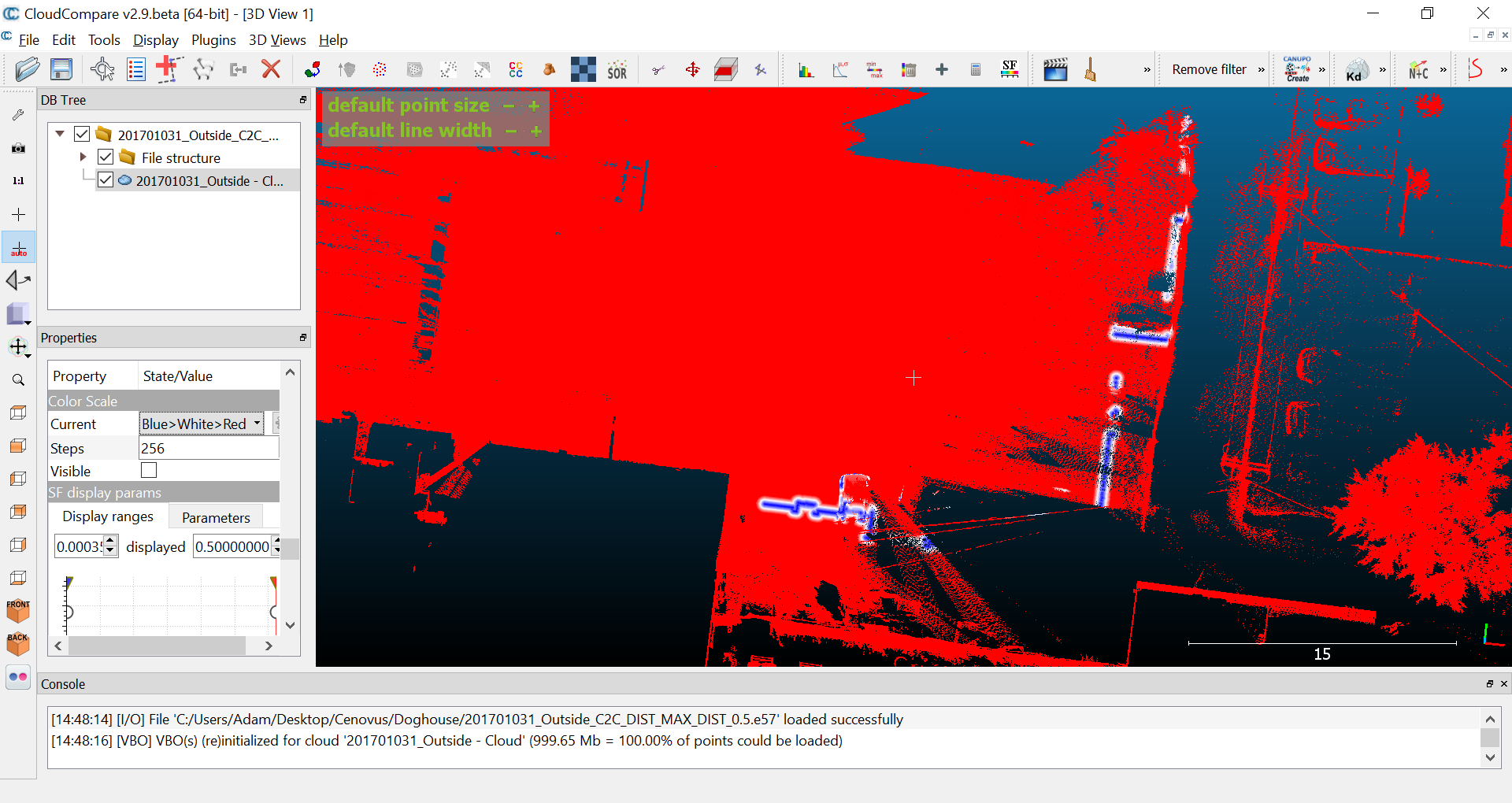

I'm comparing two different point clouds via Cloud-to-Cloud comparison.
My two input clouds are LAS files. I want to store the comparison as a scalar field and export for use in another program. To do this, I clear all the scalar fields in the LAS, run Cloud-To-Cloud, and then export the result as an e57. Exporting an e57 in this manner saves the cloud-to-cloud distance (scalar field) in the intensity field. This workaround may be part of my error, but I digress.
This process works fine when I use the GUI. However, when I replicate this in my command line, I get wildly different (and incorrect) results.
GUI (correct): https://www.dropbox.com/s/v4v53v1k4znn426/GUI.png?dl=0
Command Line (incorrect): https://www.dropbox.com/s/5ggvv4qre8azc ... e.png?dl=0
Perhaps somebody can shed some light on this. Thanks in advance,
Adam

C:\Program Files\CloudCompare\CloudCompare.exe -silent -auto_save off -O C:\...Cloud1.las -O C:\...Cloud2.las -remove_all_sfs -c2c_dist -max_dist 0.5 -C_EXPORT_FMT E57 -no_timestamp -save_clouds
My goal was to replicate the manual workflow, which has been successful
1. Import two LAS files
2. Remove scalar fields
3. Cloud-to-cloud distance with max distance at 0.5
4. Export cloud as e57 (and thereby save new scalar field)
5. Continue work with e57 in other software

So, I did some more testing with the command line. I ran the same command line, but with "global_shift auto" after the open command. Both of these attempts produced the same results:
Two uses of global_shift auto: C:\Program Files\CloudCompare\CloudCompare.exe -silent -auto_save off -O -global_shift auto C:\...Cloud1.las -O -global_shift auto C:\...Cloud2.las -remove_all_sfs -c2c_dist -max_dist 0.5 -C_EXPORT_FMT E57 -no_timestamp -save_clouds
One use of global_shift auto: C:\Program Files\CloudCompare\CloudCompare.exe -silent -auto_save off -O -global_shift auto C:\...Cloud1.las -O C:\...Cloud2.las -remove_all_sfs -c2c_dist -max_dist 0.5 -C_EXPORT_FMT E57 -no_timestamp -save_clouds
Output: https://www.dropbox.com/s/ncb2c4trm5w3i ... c.png?dl=0
This is the output using the GUI, for reference: https://www.dropbox.com/s/k5w5ecm22f16l ... c.png?dl=0
I think I'm missing something, are you able to point it out?

In the GUI output, the cloud-to-cloud distance has been computed and displays as the intensity scalar field. When I change the Color Scale to Blue>Green>Yellow>Red, the cloud-to-cloud distance correctly displays, with Blue == 0, i.e., 0m difference, and Red == 1, i.e., greater than 1m difference.
In the command line output, the cloud-to-cloud distance has been computed improperly. The global_shift command fixed my original error, but introduced a new one. When the Color Scale is changed to Blue>Green>Yellow>Red, the ground in the scan and other surfaces that did not move show Green == ~0.5, i.e. there is a 50cm difference between Reference and Compared. I cannot replicate this output in the GUI.
Thank you for your assistance,
Adam
