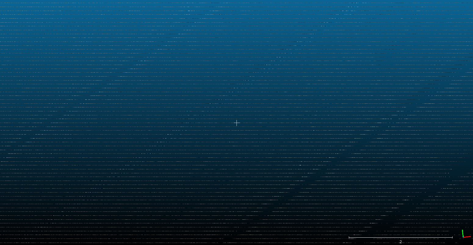

Our client complaints because our data is degraded in CC,
>> screencapture in the next post message <<
the points are laid in row, which doesn't reflect the pattern of the MMS scanner (dual scanner, pattern should be cross-profil lidar)
Any idea if it comes from your lib decoder ?
Should you which any sample please ask.

display with CC (detail zoom)
display with CC (detail zoom).JPG (221.15 KiB) Viewed 18821 times

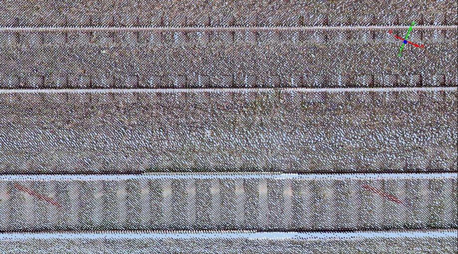

display with laszip (detail zoom)
display with laszip (detail zoom)_.JPG (218.52 KiB) Viewed 18821 times

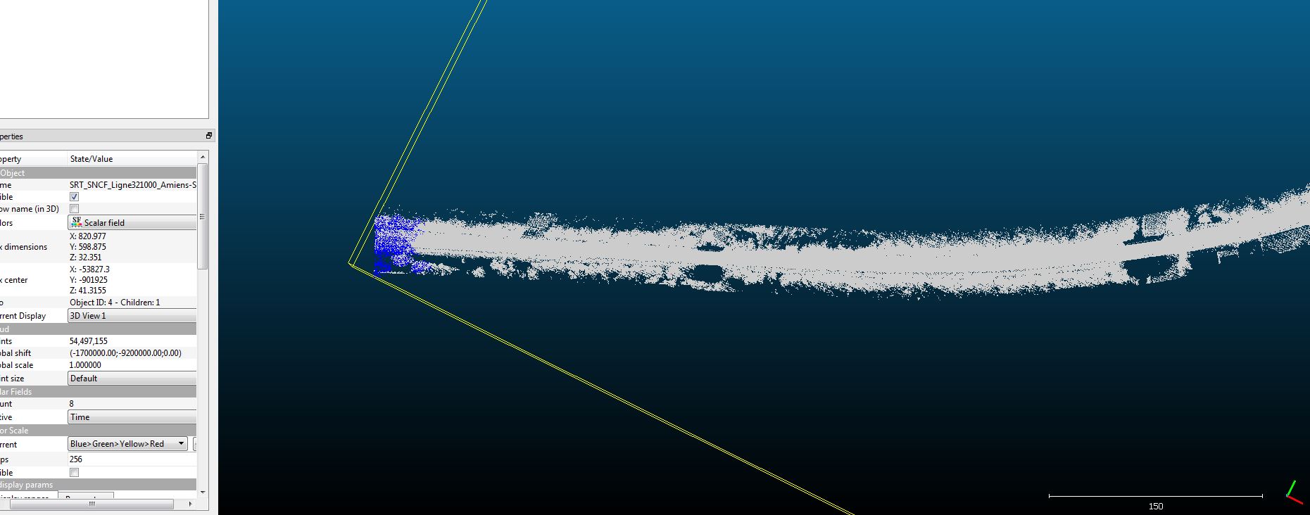

On top of that display issue there is a pb in CC when reading the time scalar field...
Here again there seems to be another issue when CC reads time from source LAZ, that SF is corrupted during import...
SF-time display in CC.JPG (130.79 KiB) Viewed 18818 times
antoine

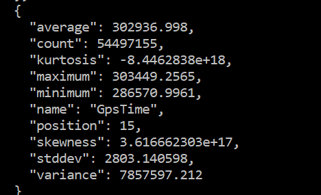

Regarding the time SF let me just detail the kind of data we use. It's derived from MMS survey. TIme is one of the metadata info stored in our LAZ file. Most of the time in second of week GPS time.
Here the railtrack has been surveyed the same day, in 2 ways on both tracks.
Time SF should be ranged between 286500 and 303400. 1 way around 286500 and the other way around 303400.
PDAL - Time metadata

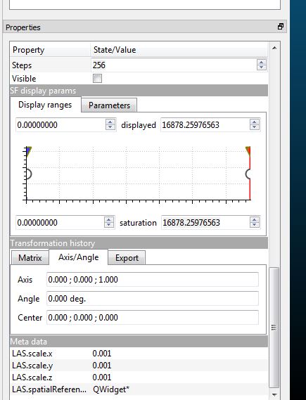

In CloudCompare after import the time SF is ranged by default between 0 and 16878 values...
time SF range in CC
time SF range in CC
It makes sens that CC shifts that physical info, 303400 - 286571 = 16900
time shift during import
So Time SF looks ok. On that sample either I crop value around 0 to 6 (few secondes during the 1 way) or around 16900 (few secondes during the 2nd way)

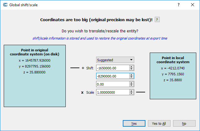

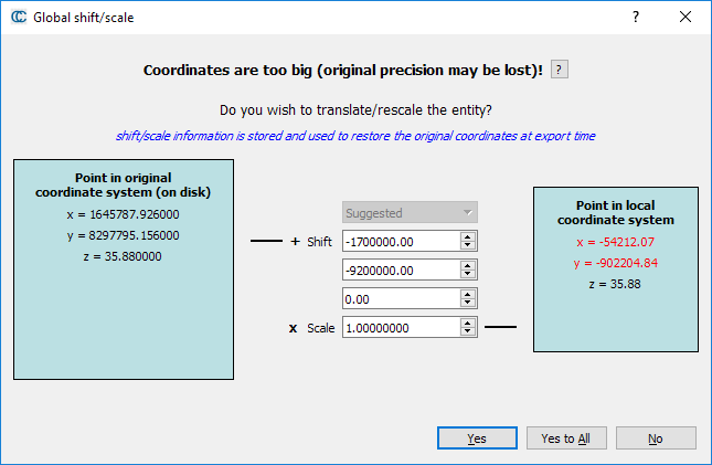

Ok, I understand now what happens with the coordinates.
By default, CC uses for LAS file the internal 'LAS shift' (or 'offset') as a suggestion for its own 'Global Shift'.
In the case of your file, this 'LAS shift' is a bit surprising as it's very far from the actual coordinates:
The resulting local coordinates are still huge! (-5e5 for X and -9.0e6 for Y). I guess you have you reasons (very long tracks?), but this kills a bit the concept of the whole LAS shift mechanism. Especially since coordinates once the offset has been removed are stored on 4 bytes (i.e. 32 bits, just as CloudCompare does). You are playing with fire ;).
Anyway this also make fail our assumption that this LAS shift will indeed reduce the local coordinates to something that can be safely stored in 32 bits floating point values. As a result (even though the coordinates do appear in red to indicate that there's an issue ;), if the users continue and clicks 'Yes', then the precision is clearly not on the safe side and they will definitely observe some rendering glitches as OpenGL doesn't like big numbers as well...
To avoid this, they have to manually fix the translation to get smaller coordinates:
Re: LAZ from laszip - corrupted display in CC
For the 'Time' scalar field, I remember now that we indeed shift the time values with the smallest time found in the file so as to avoid accuracy issues as much as possible (we don't split the fields anymore).
In your example you can easily separate both days by using the 'Edit > Scalar fields > Filter by value' tool.
