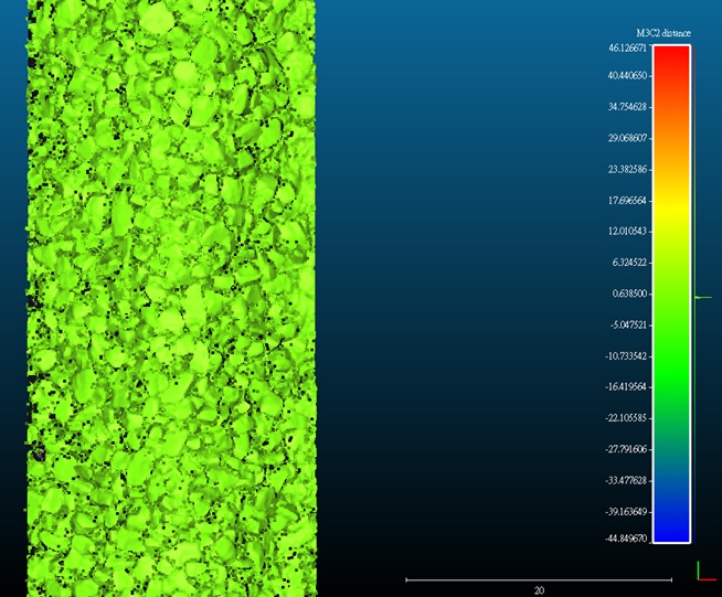

I have tried to compute M3C2 distances, 2 versions of guess params are generated
Version 1: normal dia = 0.464511; projection dia = 0.929022; max depth = 46.998202
Version 2: normal dia = 1.858045; projection dia = 0.929022; max depth = 46.998202
For both versions, the result computed are with black dots (bad normal?). How the problem can be solved?

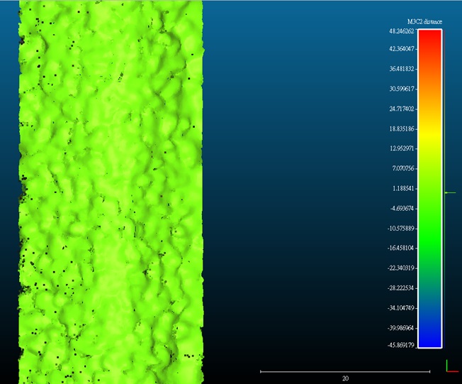

I have tried to increase the scale of normal diameter. However, as the scale value increase, the level of details decrease and the model is smoothed.

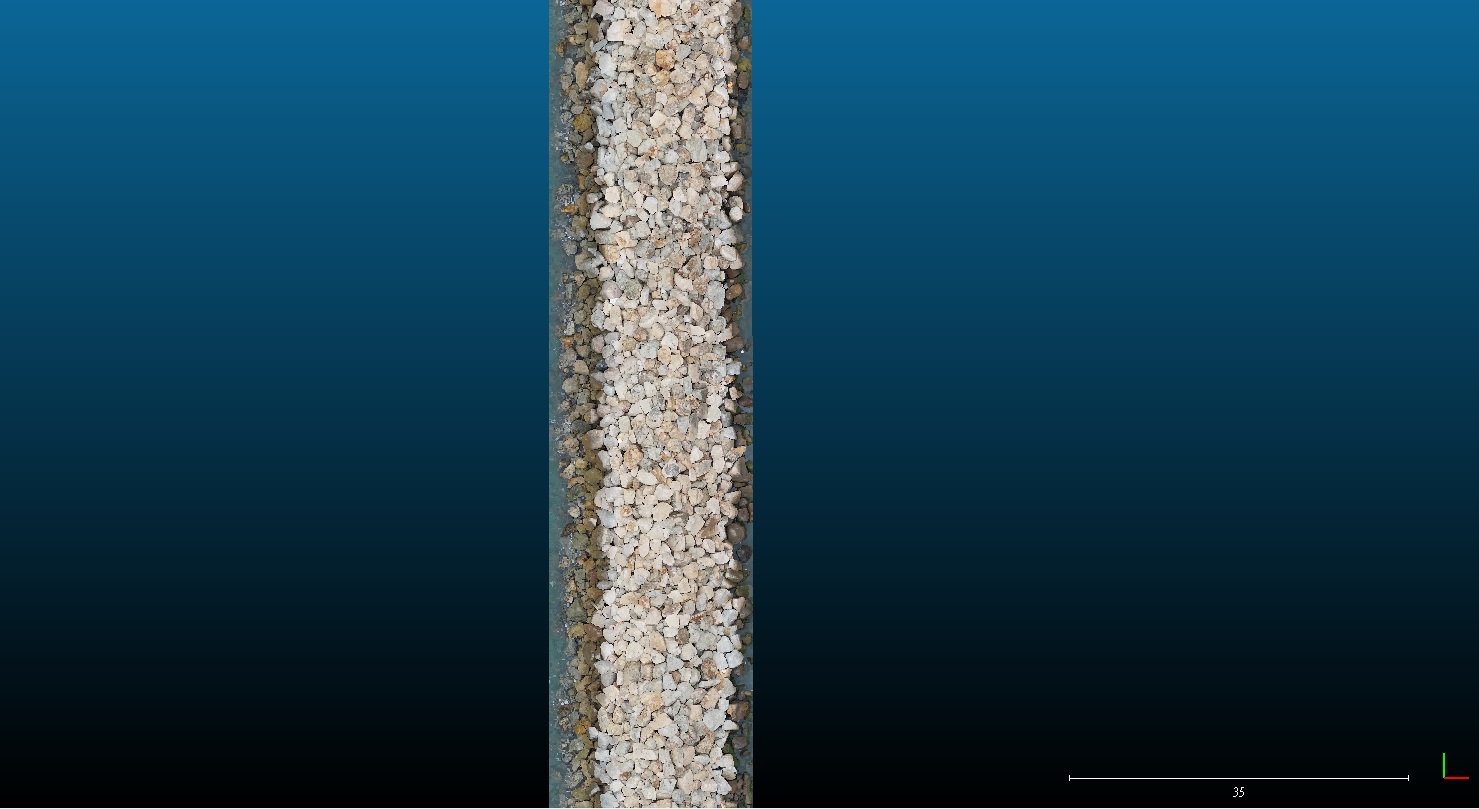

This is a part-print of my dataset

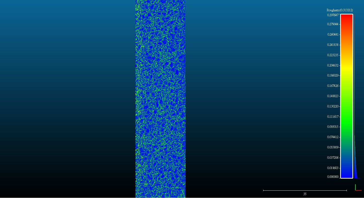

I have also calculated the roughness of the initial data
Any help would be much appreciated.

What kind of 'normal calculation method' have you chosen? In your case it seems purely vertical normals (+Z) would work well (and it would be much faster).
The 'guess params' button only do some random samplings to guess the params. This is why it can give different results (however it seems quite extreme in your case ;). If your units are meters, then 0.4 is already quite big.
If you think having non vertical normals would really help, the it may be a better idea to compute them before calling M3C2 (with 'Edit > Normals > Compute'). You'll have more options, and you should be able to resolve the bad orientations more efficiently.
Don't hesitate to send me the data (cloudcompare [at] danielgm.net) if you want more directions.
