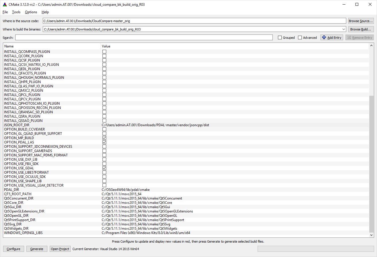

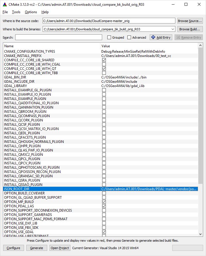

i was able to compile cc in windows "successfully" with option_use_gdal and option_pdal_las. Unfortunately I cannot load LAS files in CC.
The console writes when I try to open a file:
[09:08:09] [I/O] CC has caught an exception while loading file 'C:/temp/04_trafo_neu/1_01_20151109_151109_225733_1_originalpoints - Cloud2122323423.las'
[09:08:09] [I/O] Exception: bad allocation
attached are my cmake settings. I tried tu use osgeo4w pdal. I hope this is possible.
Do I also have to install the QLAS_FWF_IO_Plugin to be abel to read LAS?
