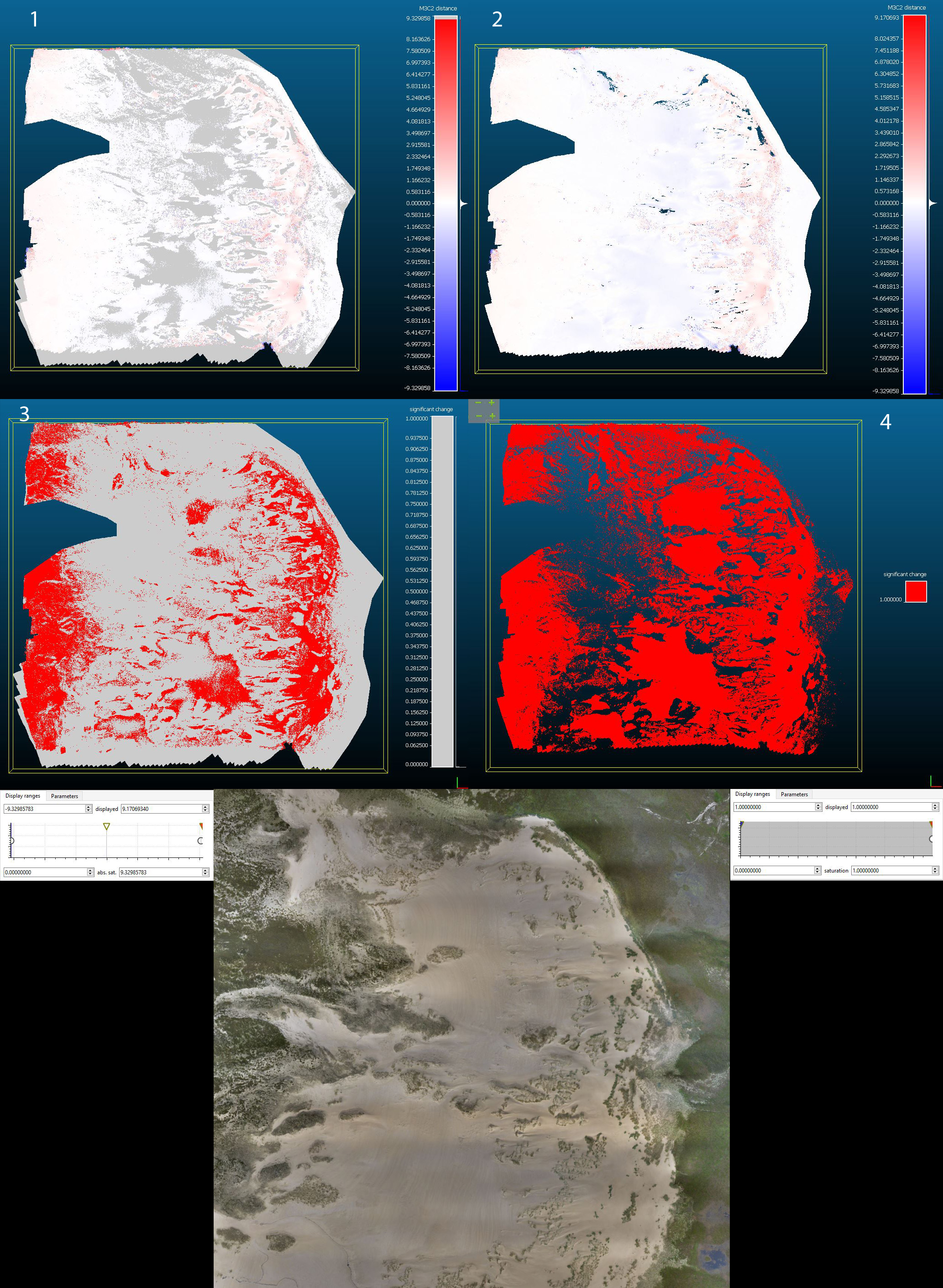

I got results and still have a few questions to it. I set the max depth projection to 5.0 instead of suggested 45.0 / used the normals within the *.ply, and set the registration error to 0.065 because of 6.5cm max GCP RMSE. This took 8 days to finish. Looking at the M3C2 output with the option "show NaN" ticked (1) there are vast grey areas. Is this the case because the "max depth" might have been too low? If it was set to 5.0 how much longer (rough estimation) would it take to compute it with 10.0 or 20.0?
Wiki tells me that for grey points no points from the other cloud could be found in the search cylinder. How come when the option "show NaN" is ticked off (2) there are still points with apparent values where the grey ones were? Can i still use these values to make assumptions?
Same question for the significant change output. Sig. change tells me where more than 0.065m has moved if i am right?
Another question is how to set the color scale correctly. Is there a link maybe with good explanations? Where do i find the value for maximum distance between the clouds? How do i set it for significant change?

8 days?! Have you first run on a subset of core points? (this is generally a good idea to avoid losing too much time and realize a parameter is wrong ;).
And yes, probably the maximum distance is too low (but if 5 m. is too big for you, then probably those points are not that interesting?
For the fact that you see points with real values mixed with NaN points is probably due to the high density of your cloud? (how clean are the normals by the way?). It's hard to tell.
And significant change is a little bit more clever than that, but more or less: yes.
You should create your own color scale: https://www.cloudcompare.org/doc/wiki/i ... es_Manager
For high res images: https://www.cloudcompare.org/doc/wiki/i ... er_to_File

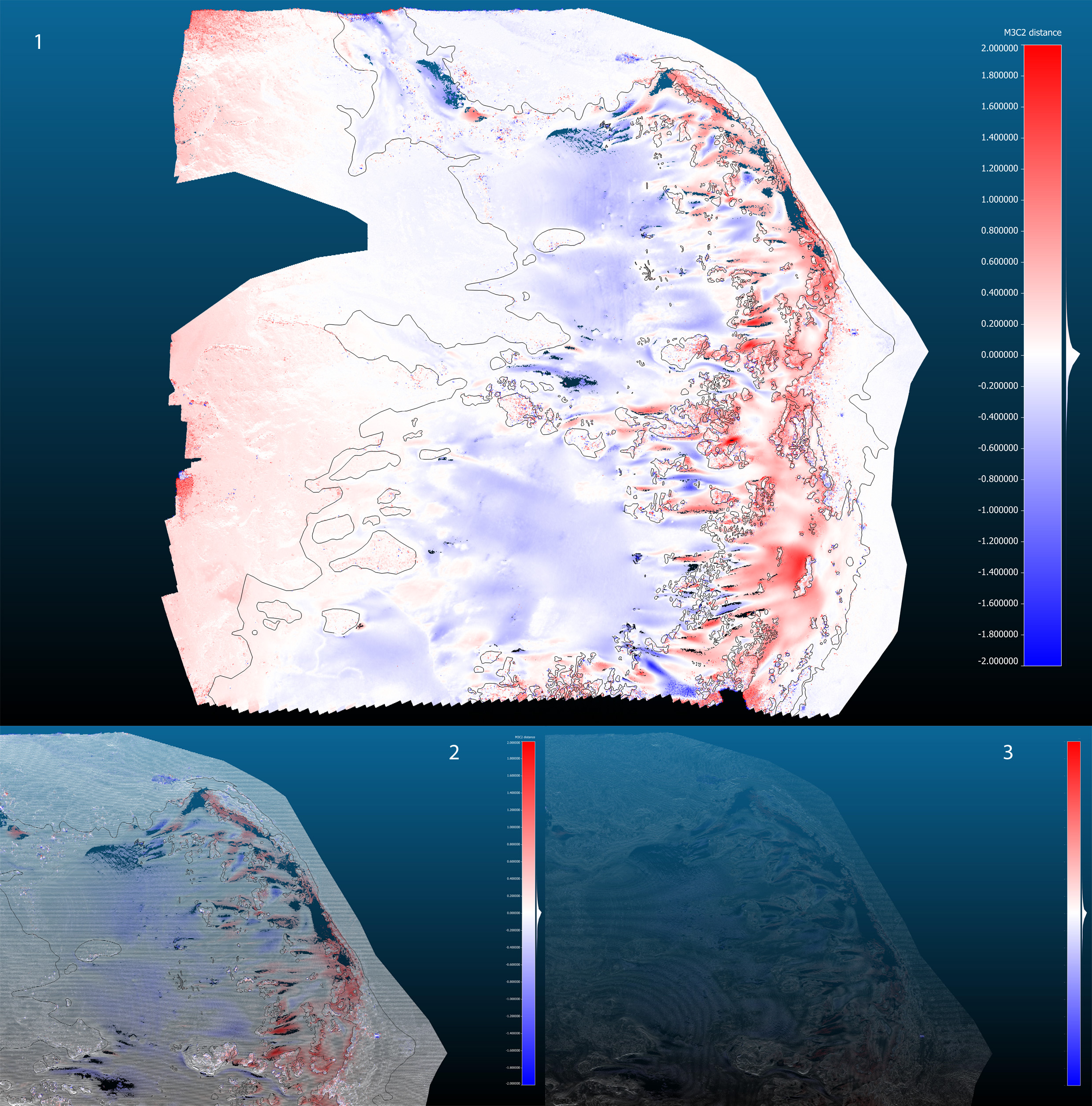

Alright thanks for your help again. Subsampling is a good idea, tried it and it worked. Created my own color scale and i could import polylines with elevation information into CC. So far so good.
Now for presentation of figures i would still need a bit help. The render to file option is good, but i dont understand it well.
When looking at the whole project (1) i get good resolutions without empty lines in between (are those lines faster render features?) but as soon as i want to get into detail, look at a specific part, i get these lines (2) (3), even though enough points should be there to fill the lines. Making (1) as big as possible doesnt show interesting parts in fine resolution unfortunately. Is there a way? How do other people generally visualize their M3C2 results?

You simply have to make the points bigger! (use the global interactors that appear when the mouse hovers the top-left part of the 3D window).
You may also have to let CC 'auto-scale' the points when you render the image (if you use super-resolution). See the corresponding checkbox in the tool dialog. If it's not sufficient, again you can increase the points size.
