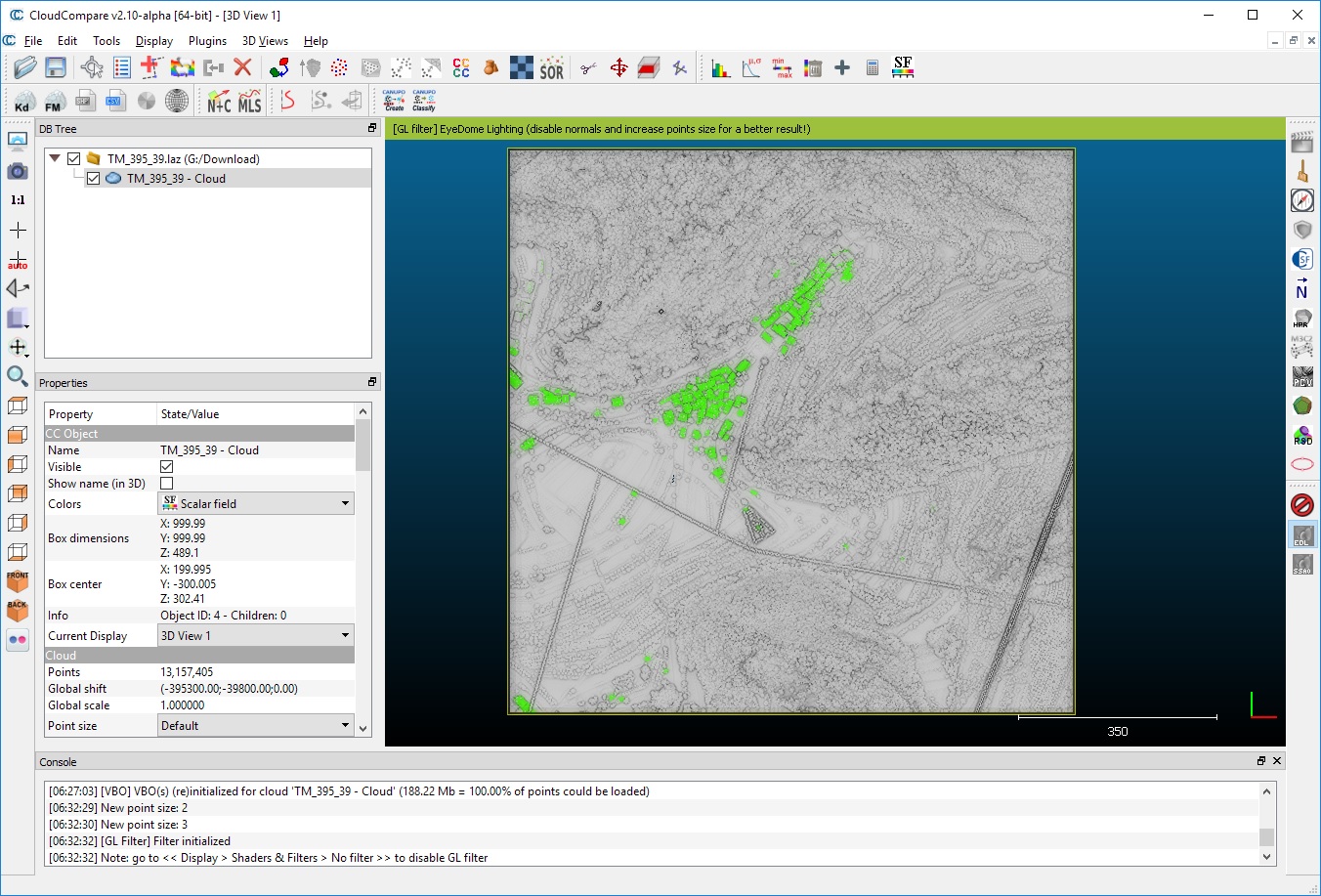

I've been going hard at the idea of making a racing game free roam map with 60km2 of the region I live in.
But I'm still experimenting and trying to write a tutorial for how someone else can do it. This is as far as I came for now.
The issue is that my government did a bad job at the classification and some points of the roofs are the same as the vegetation and then there is this lane of red points.. its all strange. When I extract only the points of the roofs, disregarding the red and green vegetation points.. the roofs end up looking fragmented.
Daniel, could you please help me out?

Hum, I may not have the time to try to process this before some time. If it's LAS classification we are speaking about, have you tried LAStools?
When I look at the file you provided, I see that the roofs correspond to the value '6' and they are pretty well classified.
The attachment cc_classif.jpg is no longer available
For the red points (value '12'), they seem to be redundant. Can't you simply remove them? Once I remove them, I get a pretty nice look:

Thank you so much for your reply Daniel!
I will check it out with las tools too..
It may appear that is classified fairly well.. but its not really.. many roofs are missing from that green 6 point thingy and they only appear when the red and other green vegetation is applied. Do you have any suggestions for that? :(
