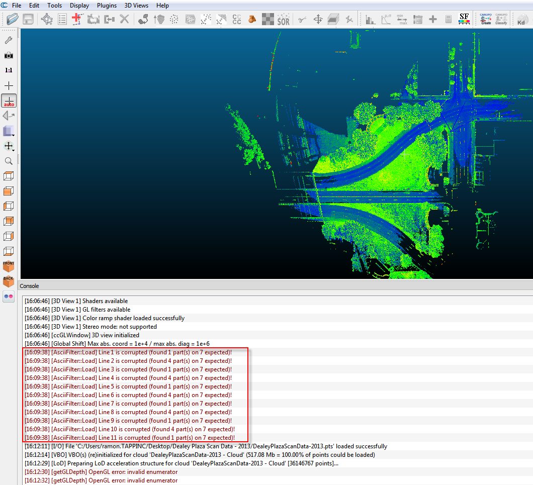

This is the first time I deal with point cloud files. I received one, coming from a Leica Geosystems scanner which has 36,146,778 lines. When I read it with CloudCompare there are errors about the first 11 lines.
Perhaps this is a non-standard file format in which the top 11 rows have a special meaning?
TIA
The attachment 11 Corrupted Lines.png is no longer available
11 Corrupted Lines.png (330.65 KiB) Viewed 4000 times

Please find below the first 100 lines of the file in question.
1
232.726245 61.778862 4.200925 0
1
1
320.551138 83.196514 4.490734 0
1
1
-5.029209 55.046426 -1.649485 0
36146767
68.260166 -58.567050 -11.726666 -164 117 131 104

Re: Is my point cloud data unusual?
Interesting, this file looks actually a little bit more like a PTX file than a PTS one (the first lines seem to correspond to a matrix, probably the position of the scanner). But it's not a big deal, CC will simply ignore those lines.
