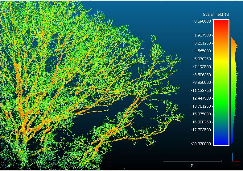

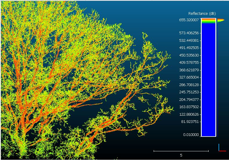

I work with Rielg TLS, CC handle very well all the workflow. One of the advantages is to read the *.rds format keeping part of the information of the scan such as [xyz] coordinate, Reflectance [dB], Amplitude [dB], Deviation, Flags. All the scalar fields match to the data exported by Riegl soft(Ascii) except the Reflectance [dB].
For CC the reflectance range 0.01 to 655.32
For Riegl soft reflectance range -20.33 to 0.69
What transformation was used to get those results?
Thanks in advance.
txt riegl.JPG (201.11 KiB) Viewed 4823 times

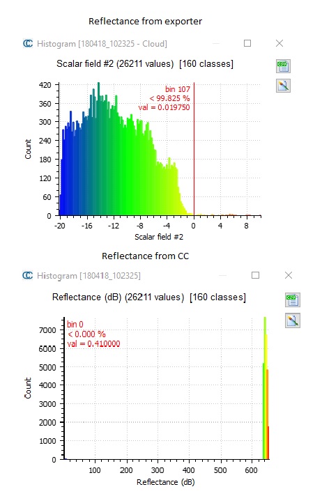

By the way, I just notice the CC only read the positives values in [dB] units then is applied a linear transformation ( y = x - {~655.36} ) for the negatives [dB] values.
For CC values {0.01, 0.34, 0.69}, 635.03 ......... 655.32
For the exporter (Ascii) values -20.33 .............. -0.04, {0.01, 0.34, 0.69}
These number {0.01, 0.34, 0.69} are the same in both cases.
That's why the histograms seem like this:

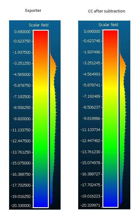

To be honest, I do not know what might be the correct transformation, but if all values >= 100 (to make sure not delete the true values read for CC) is subtracted by 655.36. The result is pretty close to the value from the exporter. It can not be the same due to the large decimal in the values. However, is not the real solution.
Re: How is "*.rds format" read it by CC ?
Okay I fixed that in the code. It will be available in the next (beta) release.
Even though it's not 'perfect', it's still better than the previous version ;). Many thanks for the feedback and the tests.
