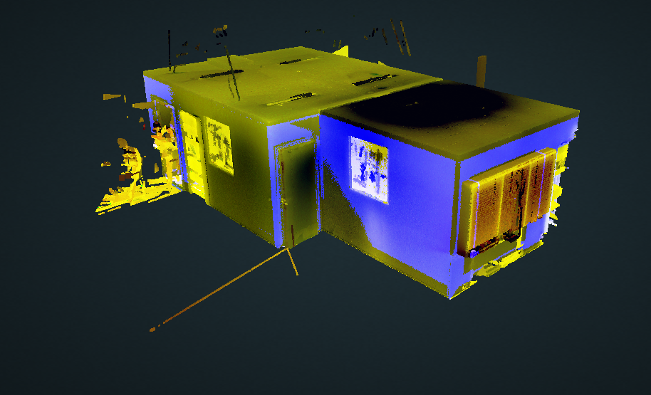

You're right! I didn't know CloudCompare had options for saving as ASCII, but now I've hit another issue. The colors are way off when the model is loaded in Potree. Instead of being blue/green/red (like the comparison in CloudCompare), it's now yellow and blue.
Re: CloudCompare and Potree
Colors are not saved in the cloud by default, only the distance values. They are then mapped with false colors by CloudCompare or Potree, in a different way I guess. In CC you can change the 'Color ramp' associated to each scalar field. You may have the same mechanism in potree.
Another option is to convert the fake colors currently associated to the scalar field as colors (Edit > Scalar fields > Convert to RGB) and then save the ASCII file (in which case the file will contain both the distances AND the mapped colors). Potree should be able to use this information instead of the distance values.
