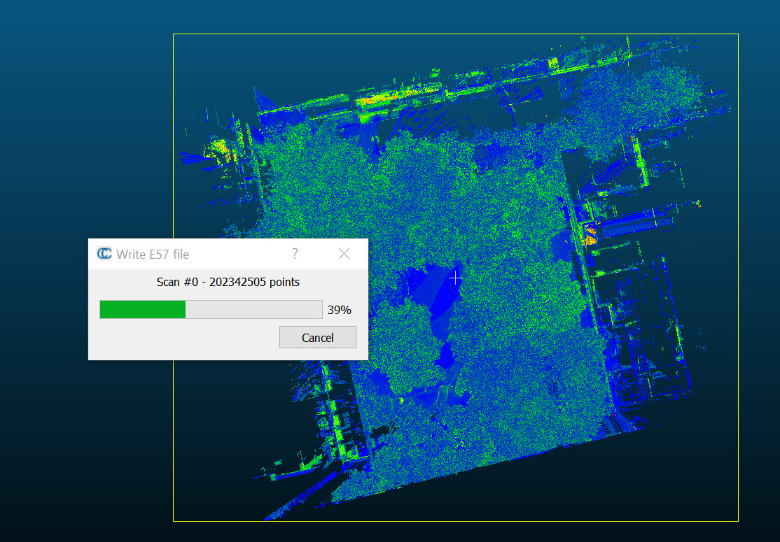

Yes, I think so because the same point cloud can be saved as .e57 format without any problem.
In the case of pcd export, Cloudcompare just quits quietly within 10 seconds or so after clicking the "save" button without the export dialog even pops up.
