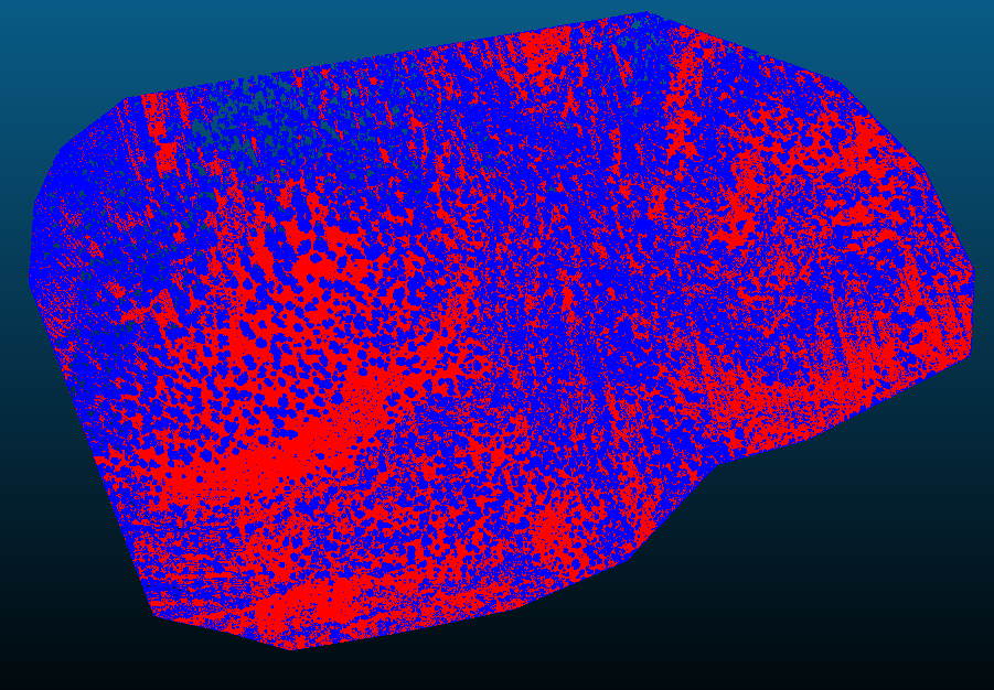

I started using CANUPO Plugin recently and got a pretty good result showing a classification of vegetation and ground from a LiDAR point cloud data. Is there any way to extract and export the vegetation and ground separately as point cloud from the CANUPO result?
I attached the CANUPO result I got.

See the 'Edit > Scalar fields > Filter by value' tool (http://www.cloudcompare.org/doc/wiki/in ... r_by_Value).
