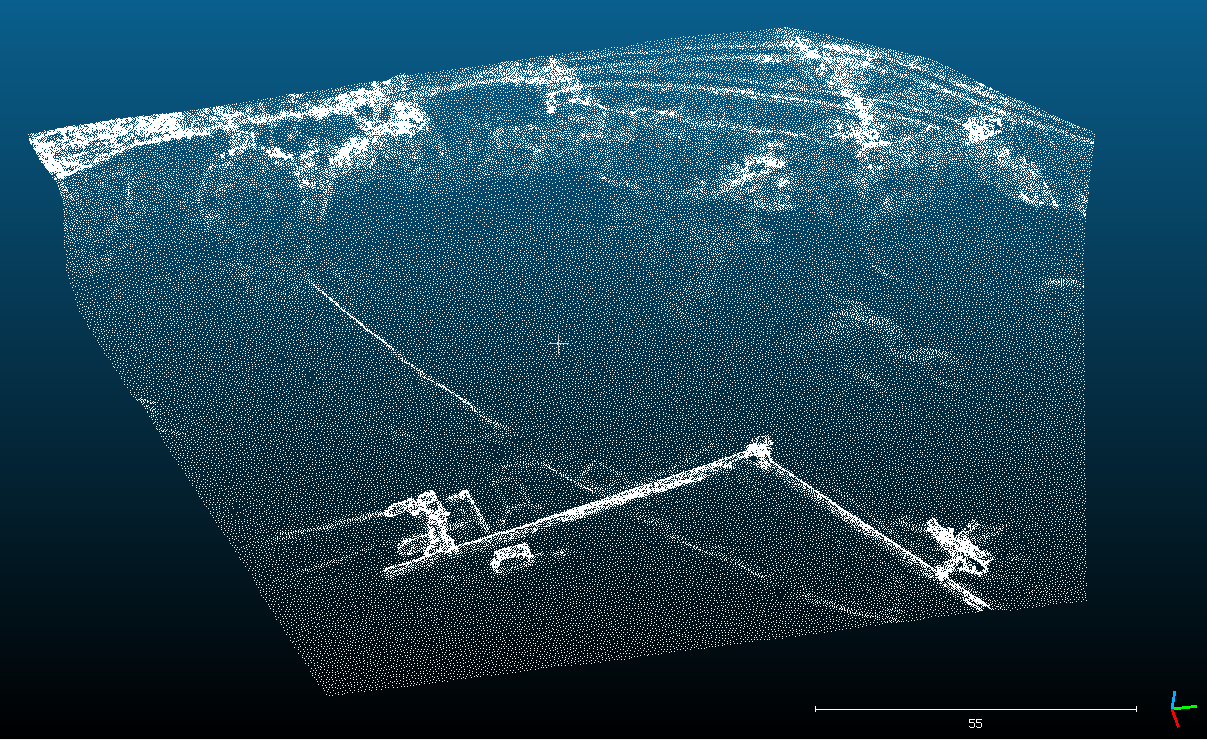

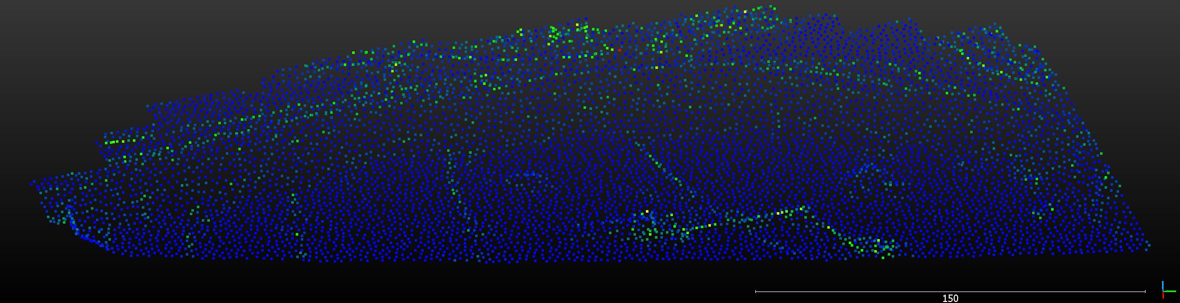

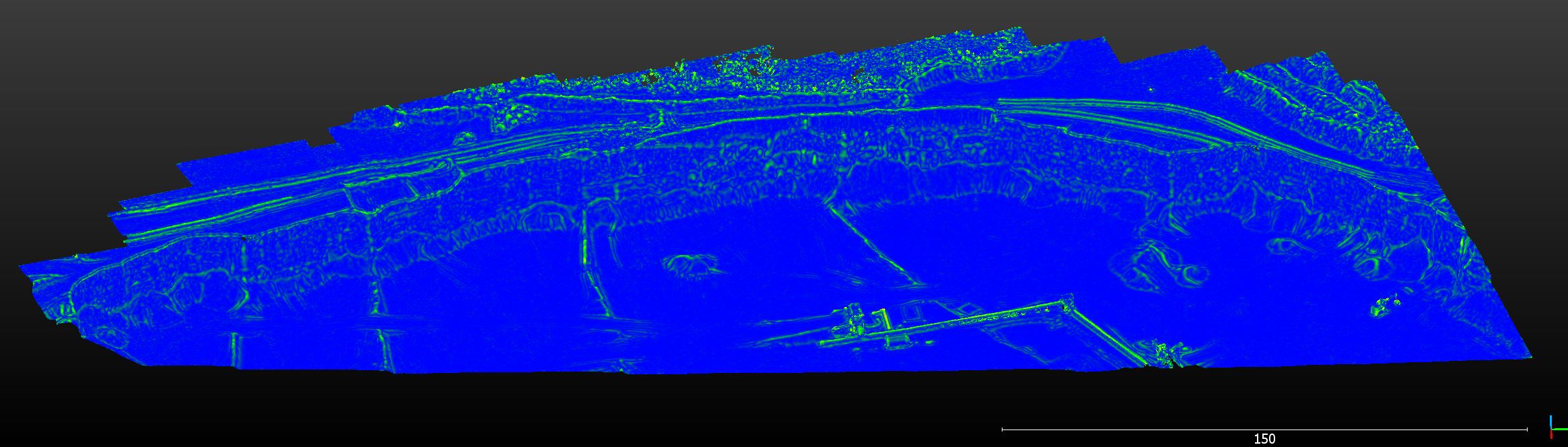

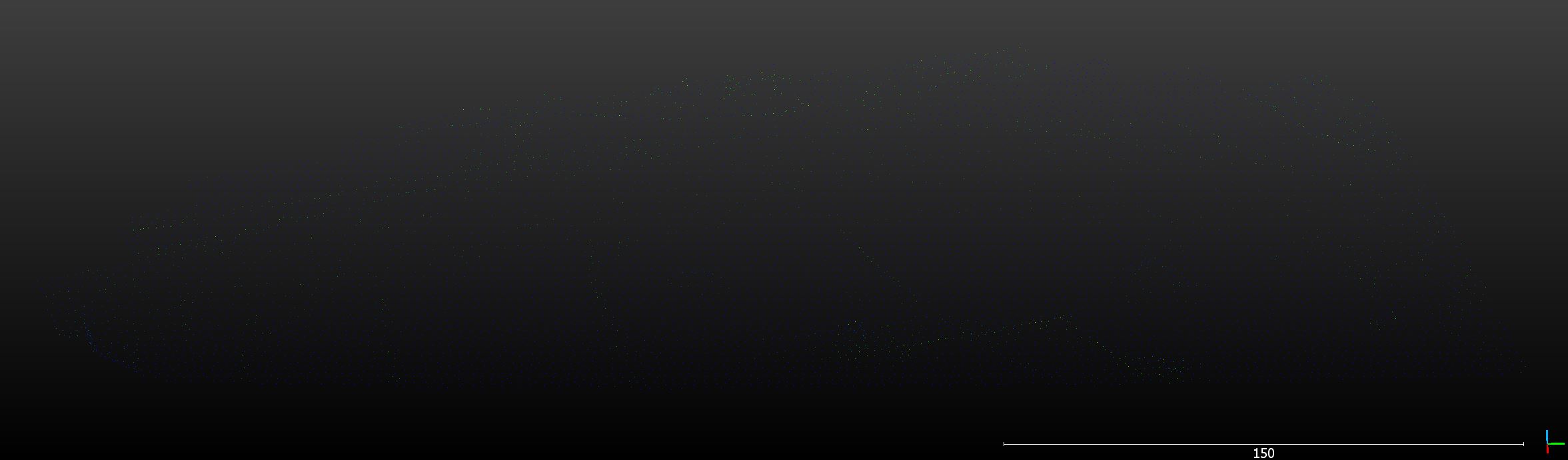

Dear Daniel and users,
i am using this method from time to time and it always worked very good (like in the description).
With my current version 2.10.2 it does not do the subsampling like expected. Points are almost gone no matter what is entered as values.
SF looks great and edges come out very clearly. When doing the subsampling the results are almost invisible points. Just like SF would not be respected...
I have no clue why this always happens now. Tried several params (inverted values, variety of min/max values etc.)
Looking for ahint into right direction
Thanks a lot
Alex

Re: Sampling edges pointcloud
Thanks for the cloud.
I'm not sure if anything really changed (but in 2 years that's definitely possible!). What I can say, is that to make the subsampling work with a scalar field, this scalar field should have a more or less linear behavior as the ratio between the scalar values and the subsampling radius is a simple proportionality.
One issue with the curvature, is that it's generally not following a linear pattern. More an exponential one with a few points with very big values (when you consider the histogram). To cope with that, you should apply a log10 function to the scalar field (with the SF Arithmetic tool).
On a test I did with the dataset you sent me, I obtained values between -6 and -1 (more or less). If I map that to a spacing of [1.0 0.0] (i.e. 1 meter for very small curvature values - for which (log10(c) ~ -6 - and no subsampling for the highest curvature values (for which log10(c) ~-1), then I get something interesting: The big challenge is always to get the scalar field (histogram) right in order to apply the proportional mapping correctly. This tool in its current form is a bit limited regarding this mapping.
thanks for the quick reply and sorry for not answering so long. I definetely have to double-check my notification settings here :(
Ok, so i took another gravel pit example with even sharper edges so the differences in plane and rounded areas are even more obvious.
I used the mean curvature tool (set at 0.5) which "detected" curvature and edges very nicely.
Then i put a log10 on the SF which turned the SF-values deeply in negative range (ranging from -7 to 0.5) and subsampling doesn't work on negative values. So a added 7 to the SF again to shift the wohl range into positive values and again did the subsampling. Unfortunately the results are still not very promising. I think i will not come back to the old results and need to experiment some more time. Maybe other tools fulfill my needs to keep dense points at edges and curvature and to reduce points in plane areas.
Thanks a lot for your support.
Greetings
Alex
Greetings
Alex
