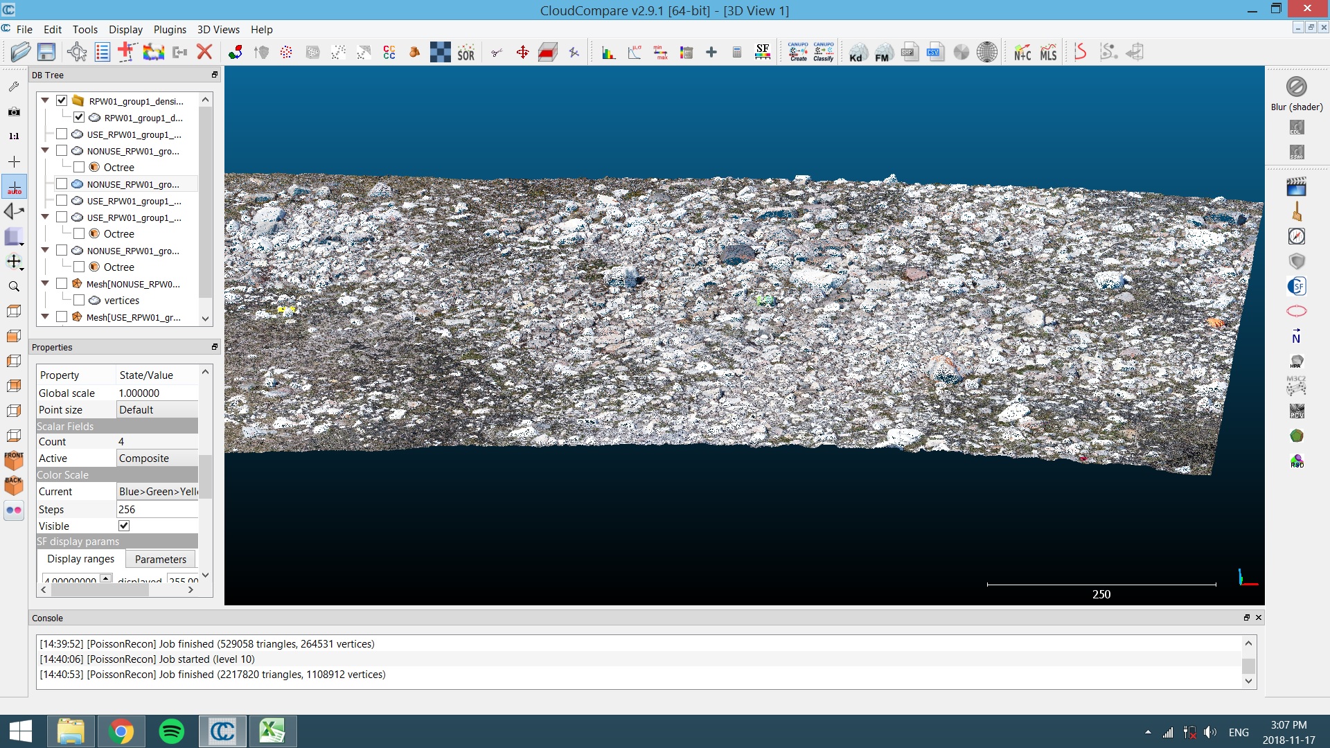

I am working on a project analyzing microtopography at arctic breeding shorebird nests. Nest sites were surveyed with a drone, and the files converted to .las point clouds using Pix4D. Microtopography refers to small (typically less than 30 cm) bumps/hummocks that cover the landscape. I've attached a screenshot of a point cloud for reference. The scale of this project is quite small, with the point cloud measuring roughly 10x15m^2.

Hum, hard to give you precise directions as each problem needs specific processings and steps (no 'out of the box' tool here ;).
Look for curvature and roughness computation tools (see http://www.cloudcompare.org/doc/wiki/in ... le=Methods).
Maybe it's possible to automatically detect nests with the Canupo plugin (for classification): http://www.cloudcompare.org/doc/wiki/in ... O_(plugin)
This way you would be able to extract the nests and at least it will help the next steps.

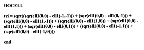

Also, I have attached a photo of a code for computing a Terrain Roughness Index from a paper by Riley et al. 1999. Full admission, I do not fully understand the computation, however I am wondering if there is a way to implement a similar kind of calculation in CloudCompare? It calculates the sum change in elevation of a cell from its 8 immediate neighbours. In the paper this is done at a km^2 scale, however it would be much smaller in this case. So a further question would be if it is possible to specify the 'cell' size used.

- the code you provide is for a raster (not a point cloud). On a cloud you could do the same by using the nearest neighbors inside a sphere (but you would end up with a sum based on different number of neighbors for each point) or with a fixed number of neighbors (but the extent of the neighborhood would change for each point). In this case it's better to normalize the result (e.g. by the number of neighbors in the first case). And in this case it's equivalent to computing the elevation scalar field gradient (Edit > Scalar fields > Gradient).
