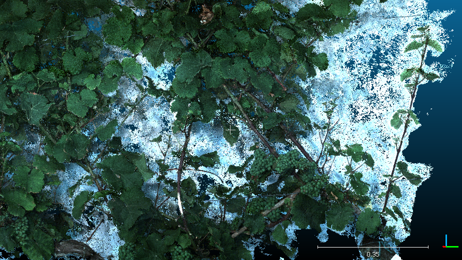

We take photos from different angle of the grape vine. The photos are georeferenced. With the software Agrisoft Photoscan we converted the photos to a point cloud . And know we have point clouds of the howl plant, with stem, leaves and a white background.
Is this answer helpful for your?
Re: Measuring volume of grape vine berries
I was expecting a snapshot but I get it.
You can try the 'RANSAC shape detection' plugin with only spheres. Hopefully it should detect the berries. See http://www.cloudcompare.org/doc/wiki/in ... n_(plugin)

Yes would be easier. I attached a file with a screen shot.
Thank you. I think i have try around for the best settings

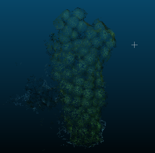

Ah, the berries are quite small. Can you maybe segment a grape and zoom in? (it would be better to test the plugin anyway). How many points do you have approximately by berry?
Uhu
Posts: 6
Joined: Wed Dec 05, 2018 7:28 pm
Post by Uhu »
Around 450 points per berry.

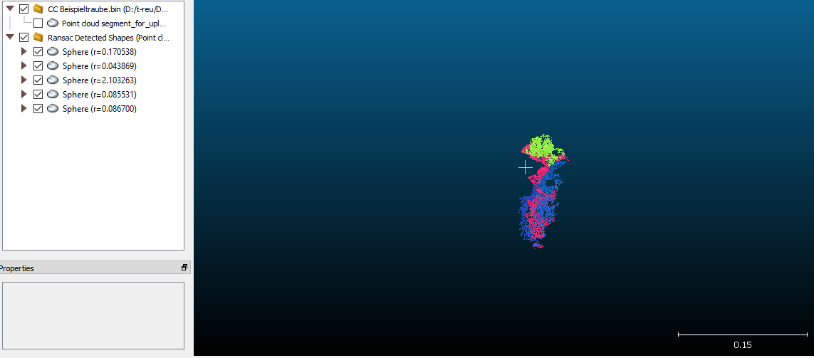

Okay, not that bad... How does the qRansacSD plugin performs?
Uhu
Posts: 6
Post by Uhu »
im not so happy with it.
I tired the tool compute 2.5D volume. I think the values of this are in the right range. IS this a valide tool for my purpose?
qRansacSD exsample.PNG (34.76 KiB) Viewed 5672 times
Hum, the 2.5D volume would work for a terrain, but definitely not for berries!
