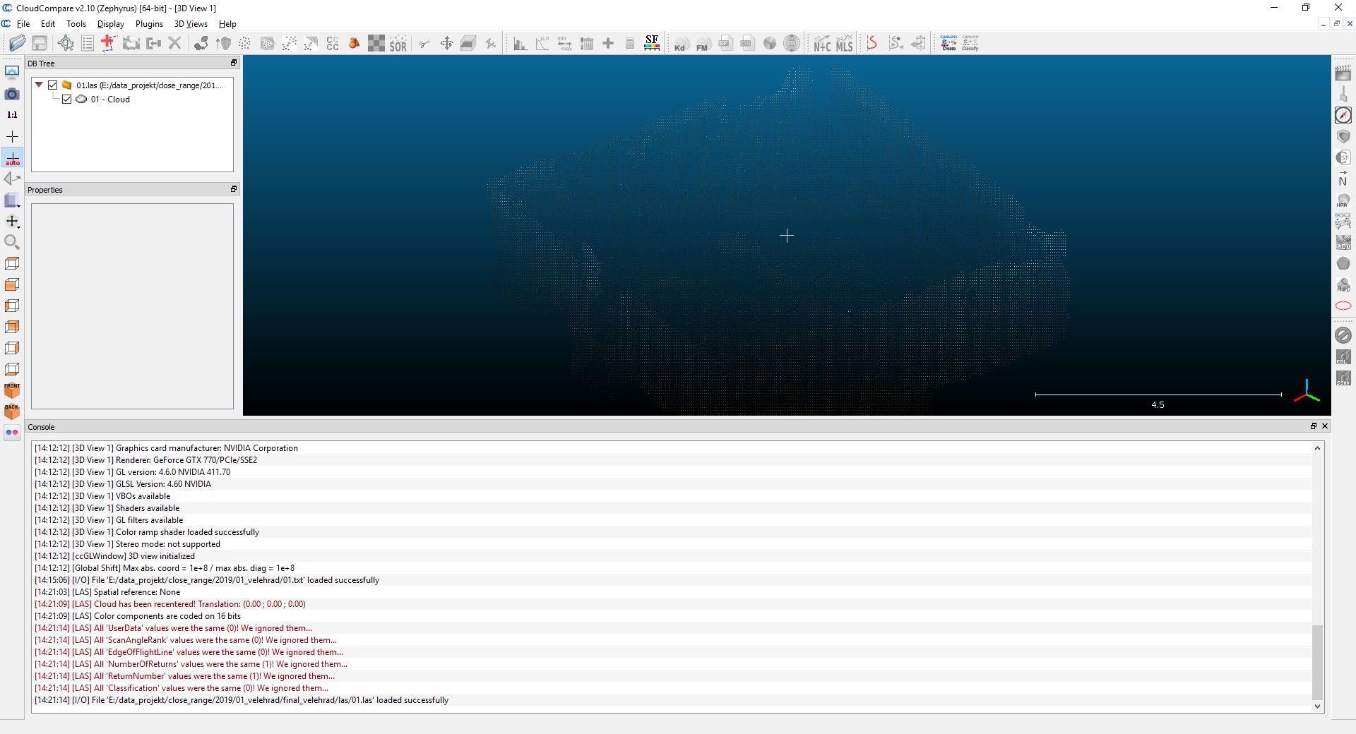

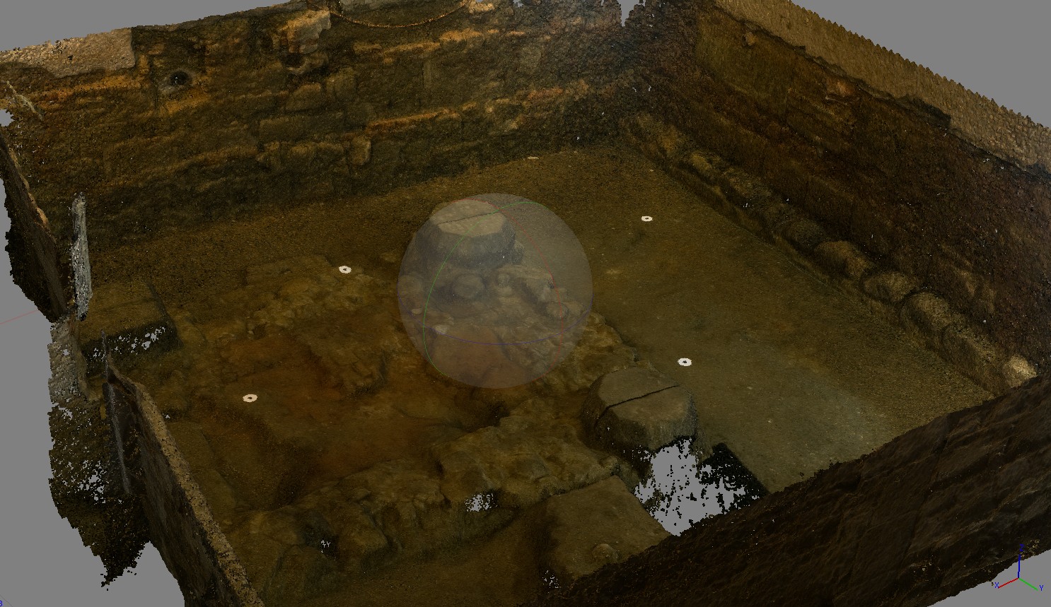

I have problem with density of my point cloud in 3D view. My point cloud has more than 6 mil. of points but in CC I am able to see only sparse cloud. In Agisoft looks everything fine. Can you help me?

View in CC
View in CC
Agisoft
Agisoft

Have you properly handled the large coordinates of your cloud? Have you accepted to apply the Global Shift suggested by CC? (otherwise you'll have this kind of 'look' where all the points coordinates are 'truncated' because of the limited accuracy of the internal representation of points).

No I did not accept the global shift and it is the problem. It is clear now. Thnak you.
