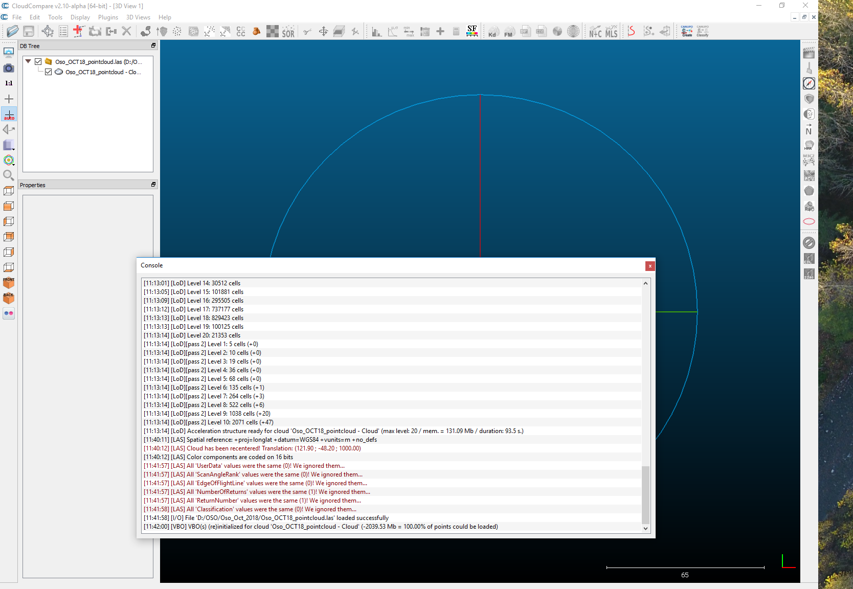

I've been having trouble just uploading my data to CloudCompare v.2 10-alpha. I've tried to upload my photoscan projects through the following forms (.psx, .pts, .las,) and a line is the only visible thing on the screen (screenshot attached). Some questions I had for you are:
1. Is there a specific point density or number of points at which the data needs to be in before it is transferred to CloudCompare?
2. What should my datasets contain in order to be visible on the screen? (ie. grain sizes/accuracies)
3. How should the two point clouds when paired together be delivered/in what format?

This generally occurs when the data coordinate system is "weird". Like a coordinate system where X and Y are expressed as angles and Z is expressed in meters, or millimeters (especially if it's geolocalized).
You have to make sure the coordinate system is 'cartesian' before importing the data in CC.
