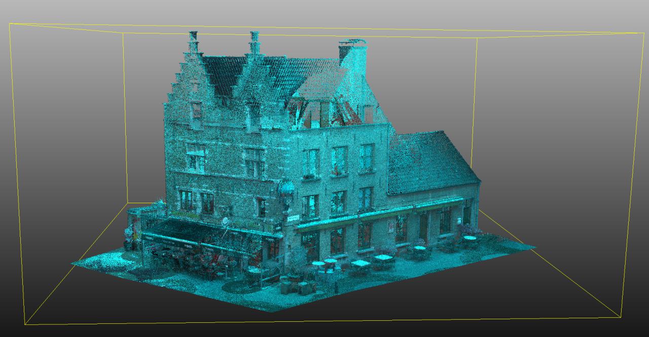

Hey guys,
Since a couple of versions I have the problem where the colours of the imported .pts are washed out and shifted to blue.
I have no idea how it happened and I can't seem to correct it.
Uninstalling and/or installing a newer version also doesn't solve it.
Anyone here who knows what's going on?
Washed out colors in pointcloud
- washedoutcolors.jpg (113.06 KiB) Viewed 7599 times

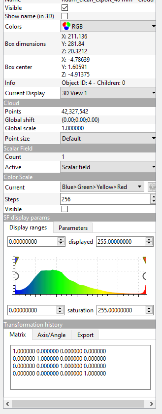

I went to [Display] -> Display settings.
There I reset the colors and materials as well as the color scale (scalar field) tabs.
This didn't do the trick..
Is this what you meant, or am I looking in the wrong spot?
*Oh, and I also reset all GUI elements.*
