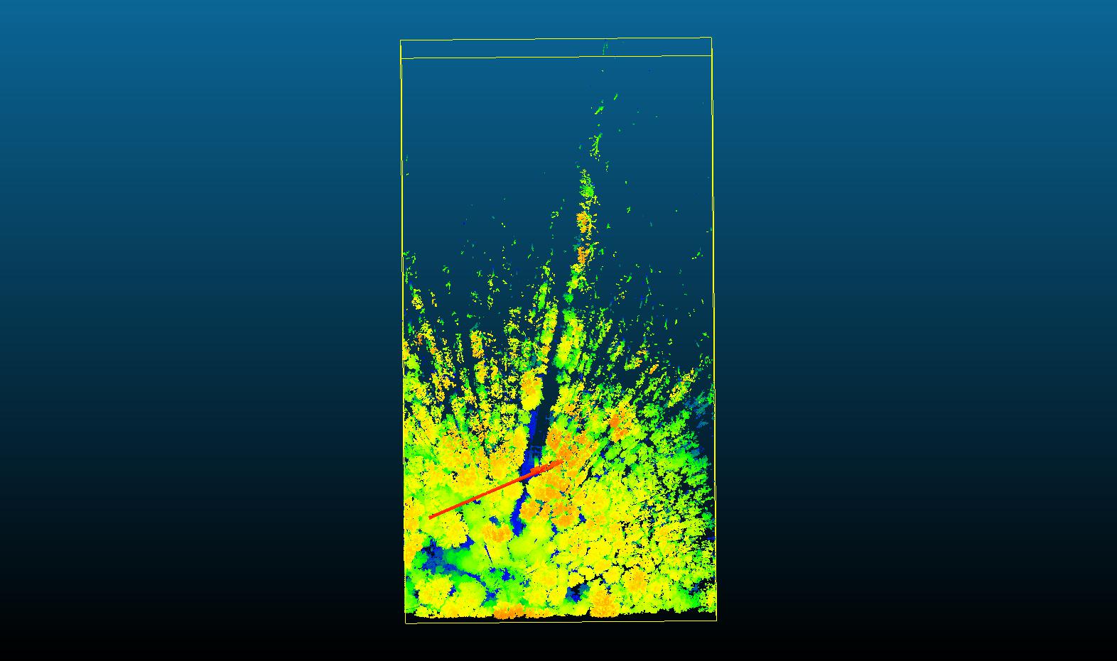

I recently started to work with point clouds from TLS - Data. I have a huge plot (over 1 hectar) of trees scanned. So it is a quite big dataset. To reduce the data I try to focus only to the area of interest (AOI). The data is geo-referenced and I do have the exact coordinates of my AOI. Basically I want to crop my point cloud to those coordinates.
My problem:
The only problem I encountered so far is that my plot isn't orthogonal to the coordinate-system. See picture one.

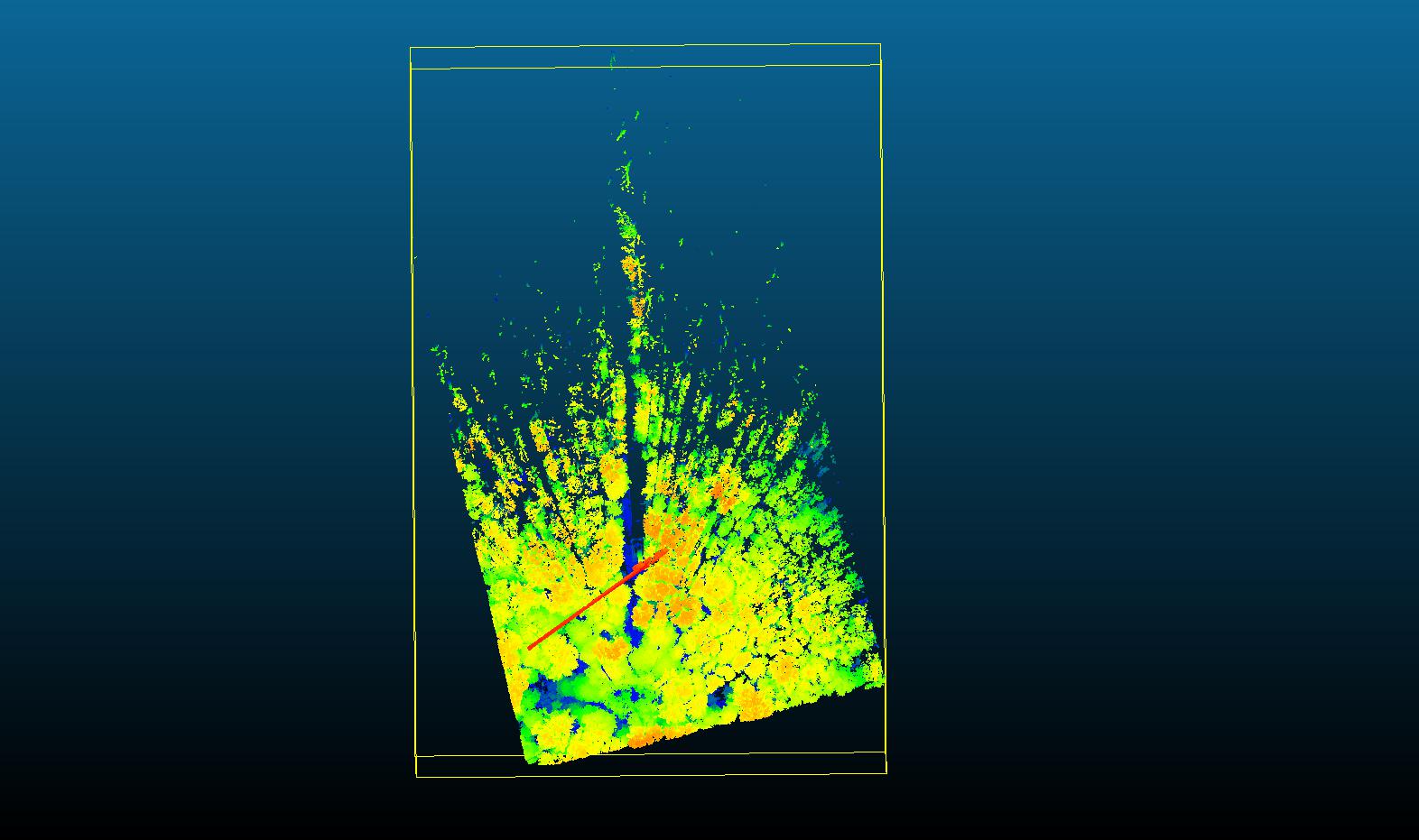

I solved this by using the Edit/Apply transformation (alt+t) and using the calculated correction angle (in this case ~12 degrees, see Picture two).
Now a have a rotated cloud, but it seems that the rotation was done around the center of the bounding shape (just guessing).
Because if I try to crop the cloud by my coordinates of my AOI, it wouldn't crop at the expected position.
In my use case it would be nice if it would rotate around my lower left corner so at least that coordinate wouldn't change.

pictures: First one displays just two out of the 146 scans of the plot, but the plot size is displayed by the bounding box. In the middle u can see a quite straight line of rails were a crane is attached
The second one is the same as above but rotated ~12 degrees, now I want to crop the point cloud again. starting roughly there where the points in the lower left corner are visable (actually I need to crop a few meters to the right)

First, the 'Apply Transformation' tool applies the rotation around the coordinate system origin (P' = R.P + T - where R is the rotation matrix, and T the translation). But whatever the way you apply the rotation, your (X,Y) coordinates will change (even slightly), won't they?
I guess the AOI coordinates are in the 'real world' coordinate system? And your cloud hasn't been registered yet? The only proper solution to handle this would be to 'align' your cloud with Ground Control Points (at least 3) so that the TLS point cloud ends at the right position... or did I miss something?
