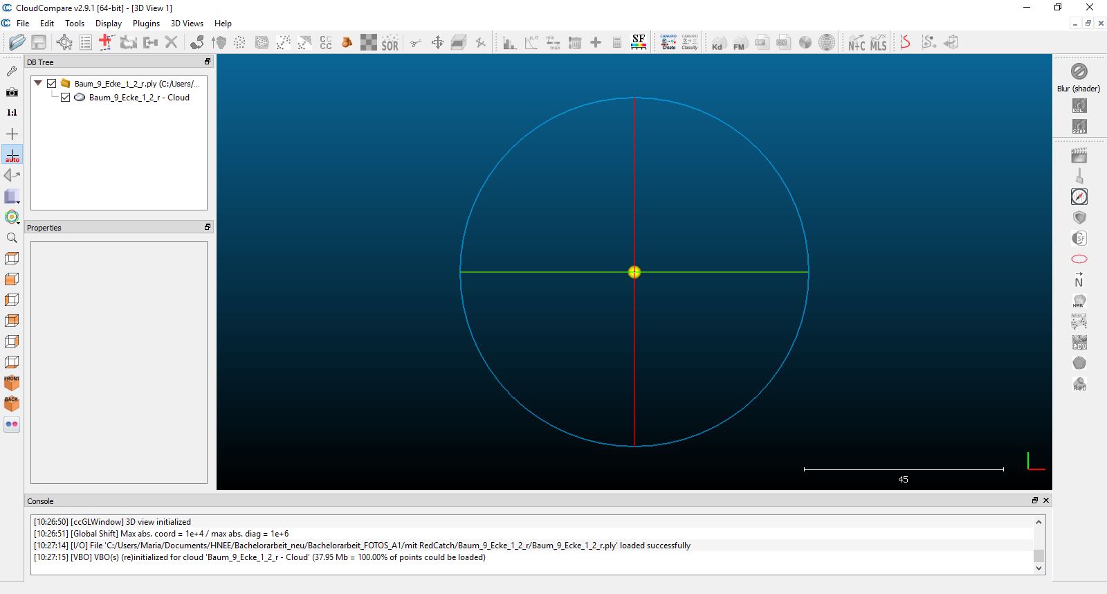

Hi everyone!
For my bachelor thesis I created pointclouds of trees to measure the diameter. For half of the point clouds I used a 3D ImageVector --Mono-- PPK camera attachment, which georeferences each photo with GNSS data.
My problem is, that I cannot open the georeferenced point clouds in cloud compare. The project is visible in the DB Tree section, but not in the main part. (picture attached)
Is there something I can do to make them visible?
Thanks for any help!
Re: georeferenced pointclouds
It can happen if all the points are at the exact same position (it may be the case in the file, or it's maybe because there's a reading error).
Can you send me the file maybe? (admin [at] cloudcompare.org)

I have the same problem with 8 data sets so far.
The ply file seems to be too big to send by email, is there another way?

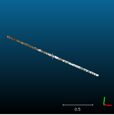

@msc818 Okay so your problem is that the points are in a strange coordinate system with XY having different units than the Z dimension.
When you load your point cloud, just rotate the camera (or look at the cloud bounding-box) and you'll see that it's elongated:
Either you find a way to export your points in a 'cartesian/homogenic' coordinate system, or you scale the points afterwards in CC (with the 'Edit > Scale / Multiply tool). But that's generally not a good idea when the differences in scale is that big (10^5!!!) as you'll lose a lot of accuracy.
