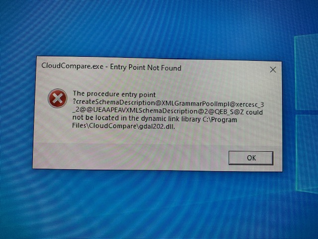

I recently attempted to install Version 2.10.2 with the FARO extensions and received an "Entry Point Not Found" error when trying to open the program. I uninstalled 2.10.2 and attempted to install 2.10.1 but with the same error. I then installed 2.9.1, again with the FARO extensions and this version of CloudCompare runs fine. I have attached a photo/image of the error message. Any help, advice, and/or thoughts on this error would be greatly appreciated. Thanks in advance for any input!

Hum, that's weird. Have you tried it with the 2.11.alpha version as well?
(it seems it uses the wrong version of the GDAL DLL...).
