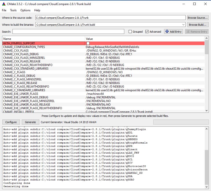

I am trying to build the CloudCompare 2.8.1 version in visual studio 15. I followed instructions BUILD.md file. I have used CMake-gui to set QT 5 Root path to C:\Qt\Qt5.8.0\5.8\msvc2015_64, and checked the QAnimation plugin to build it too.
I didn't change any other settings, apart from CMake install prefix set to C:\cloud compare\CloudCompare-2.8.1\Trunk install.

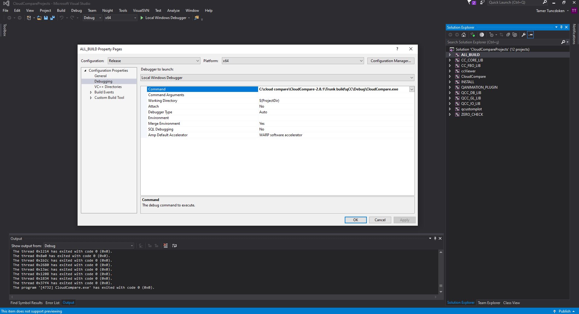

I have built the CloudCompareProjects.sln on the debug mode without any errors. I set the CloudCompare as startup Project, changed the debugging command property to C:\cloud compare\CloudCompare-2.8.1\Trunk build\qCC\Debug\CloudCompare.exe

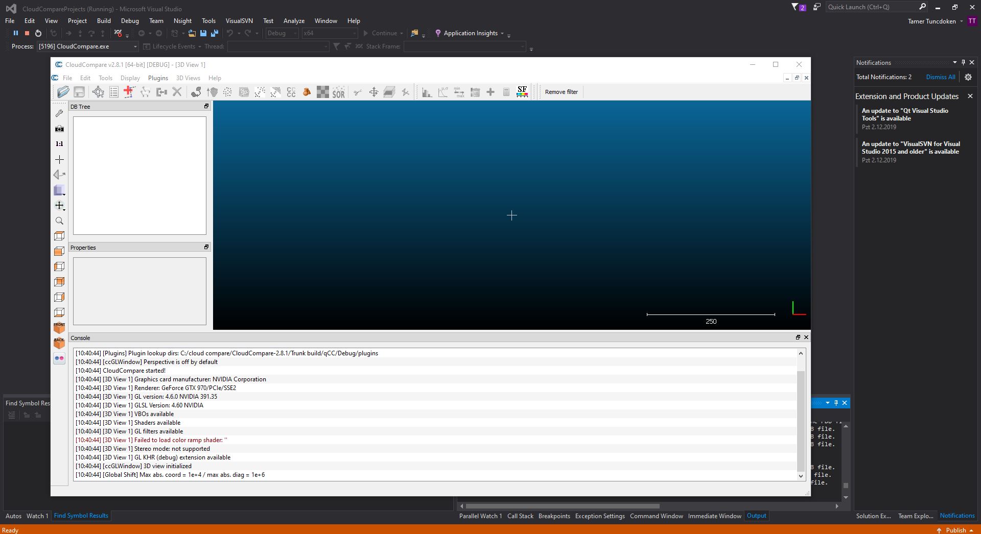

İt works with QT interface !!

The 'debug' command should be pointing to the installed version of CloudCompare.
Something like: 'C:\cloud compare\CloudCompare-2.8.1\Trunk install\CloudCompare_debug\CloudCompare.exe'.
Another potential issue is if you miss some dependency DLLs (but here it shouldn't be the case).
