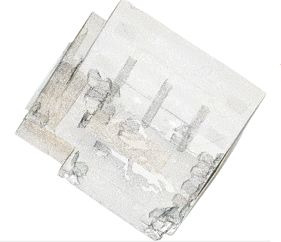

My apologies for the late response, and I appreciate all your help. Maybe I'm overcomplicating my problem, but the idea is that I want to create a "solid" view of the point cloud. Perhaps I have to do some surface reconstruction for this, but I was hoping there was a simpler solution in CloudCompare. In particular, consider the following input point cloud:
Now when I zoom out in CloudCompare, these surfaces appear to become exactly what I want, but at a much smaller scale obviously [attachment]solid.PNG[/attachment]
Is there some way to do this so that I can get this zoomed out view, but at a much larger scale?

So either you increase the points size (with the +/- interactors that appear in the top-left corner of the 3D view). That's simple.
Otherwise, yes, you would need to mesh the point cloud. The most viable solution is to use the PoissonRecon plugin (https://www.cloudcompare.org/doc/wiki/i ... n_(plugin)), but you'll need normals, etc.
