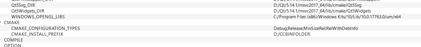

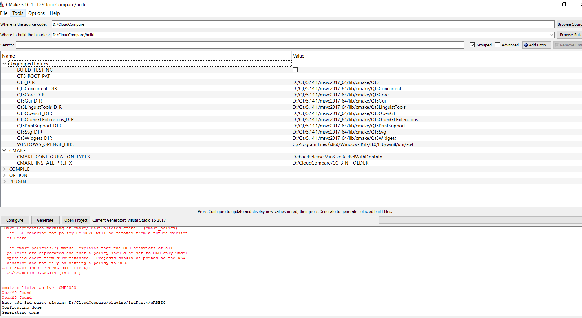

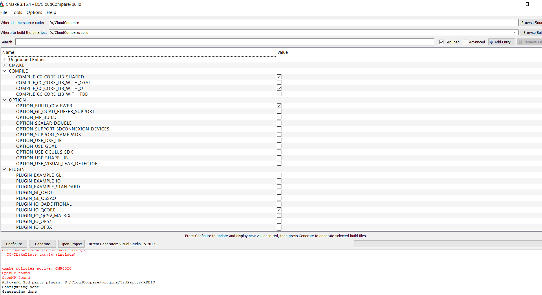

I am trying to compile CC, but getting the error (see error.png). See also Cmake1.png and Cmake2.png for more info.
I also did the following changes (see Cake3.png), but no success.

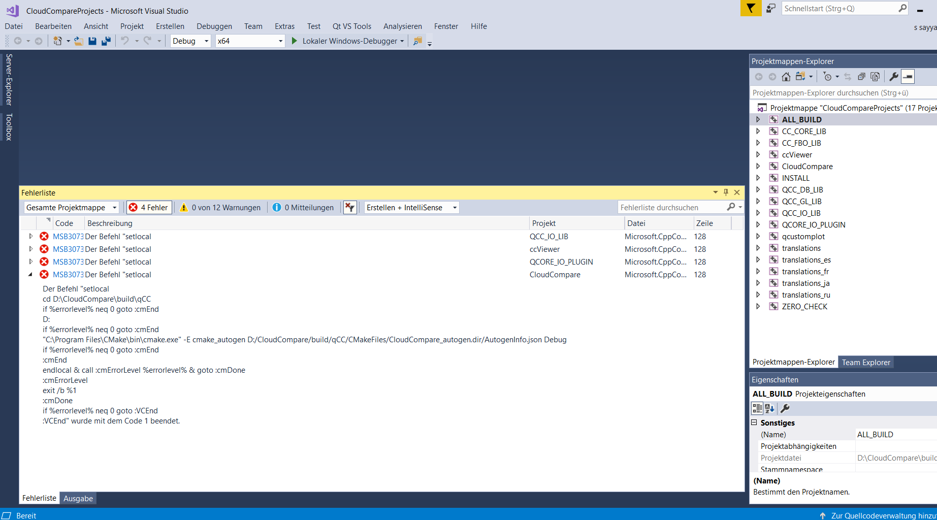

The Visual build console is generally more helpful in this case (well, maybe not in German :-p).
Is it an error with setLocale? The Qt command? In this case this might be because of the Qt version? Can you try with an older one? 5.9 or 5.10? (just in case)

No...
I tried older versions also. 5.14.....5.9. There is not so much info of error. I have only diese Screenshots.

Re: Error while Compiling CC
Can you then post the contents of the 'output' console? Should appear during the compilation process (with a lot of text, compiled files, warnings, etc.)

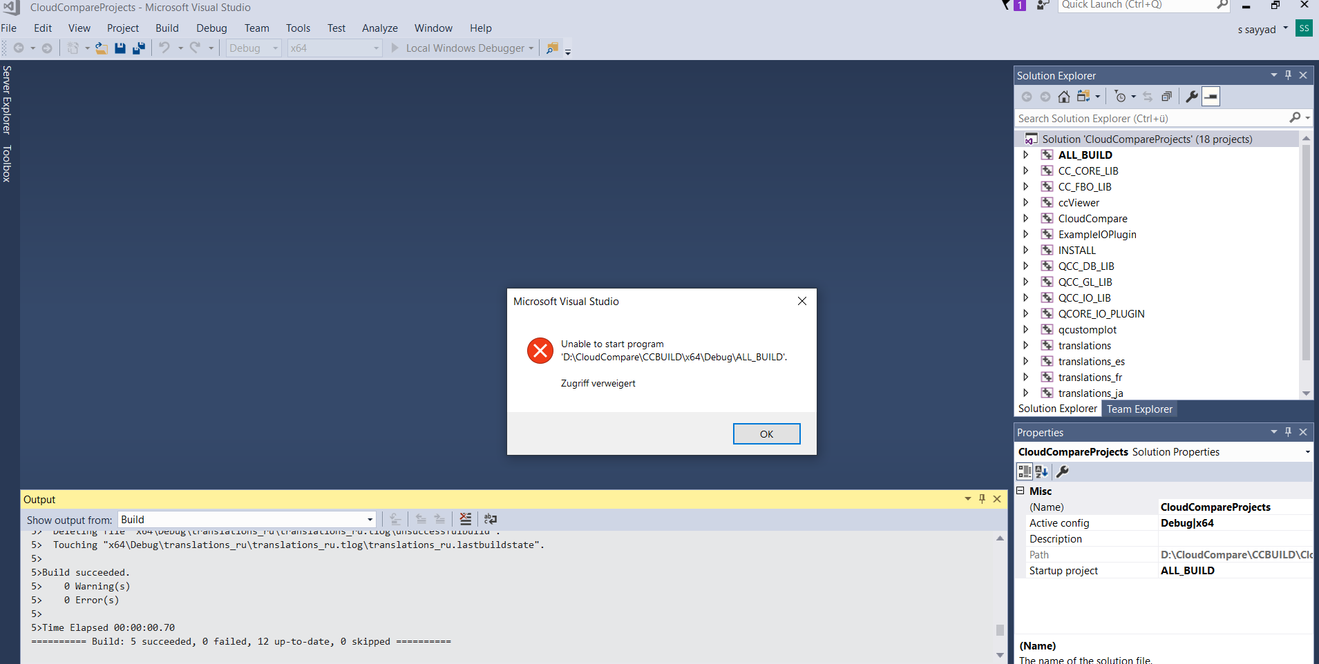

I am getting this error.
Unable to start program..... access denied.
There is no exe file in the folder. I think there is something missing and cmake is not properly working. I can send you project file as zip, but how to upload it????
Have you compiled the INSTALL project? And set the right install destination directory in CMake ? (see https://github.com/CloudCompare/CloudCo ... r/BUILD.md).
Also check the section about setting Visual Studio correctly (and the link to this message: http://www.danielgm.net/cc/forum/viewtopic.php?t=992)
