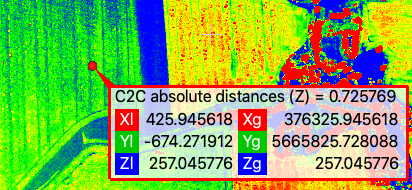

I computed the Cloud2Cloud-distance and now I'm struggling to export the results. The only way to not only see a coloured point cloud, but numbers, is by Tools -> Point picking and then click on my points of interest. Is there any other way to export the distances?

Simply export the cloud as an ASCII/Text file. You'll get the points coordinates and all their associated scalar values.
