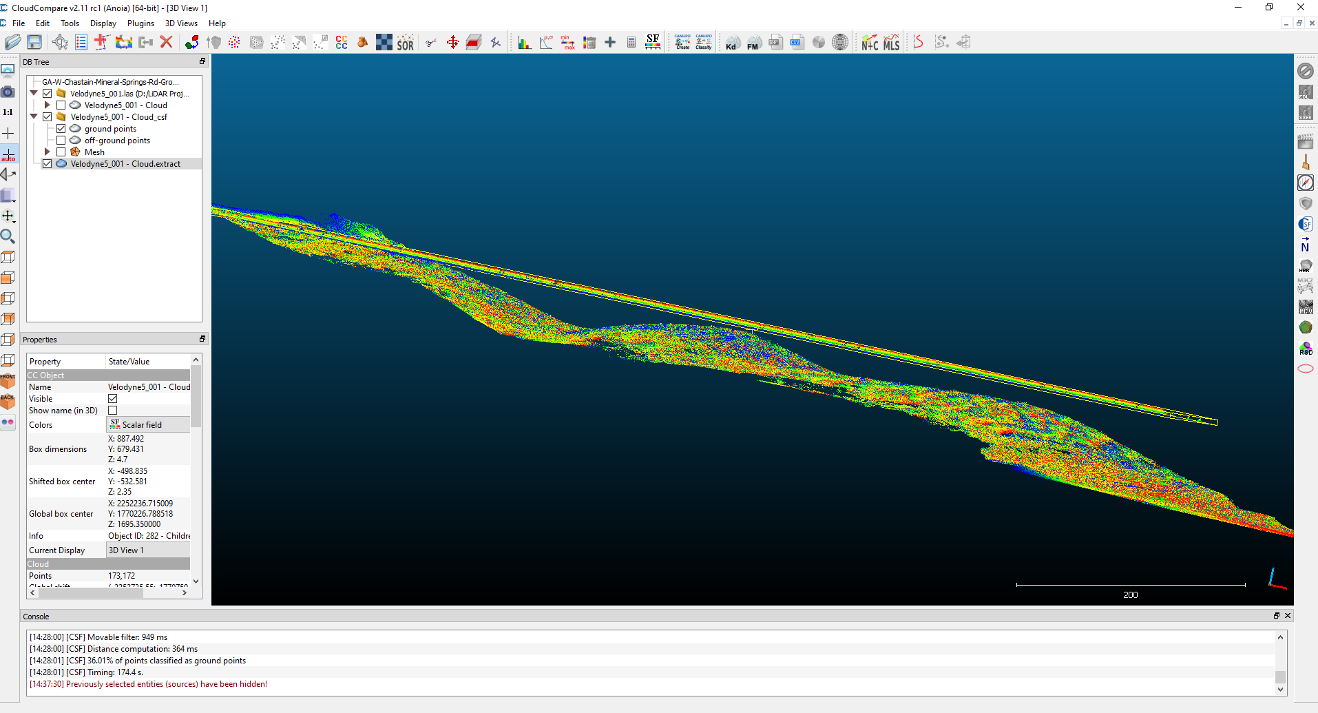

I tried the workflow suggested and I am having a few issues. I attached an image of my problem. Basically when I trim the point cloud to a fixed height it does not follow the terrain of the ground. I was wondering if I could use the mesh as a trimming edge so that I would trim everything above a certain height from the ground. I would like to be able to have everything in the pointcloud from the ground to 4.7' above the ground following the terrain. The only way I have found so far is using the segmentation tool and manually trimming but I would not be able to trim at a fixed elevation using that method. Thanks very much this has been very helpful.
