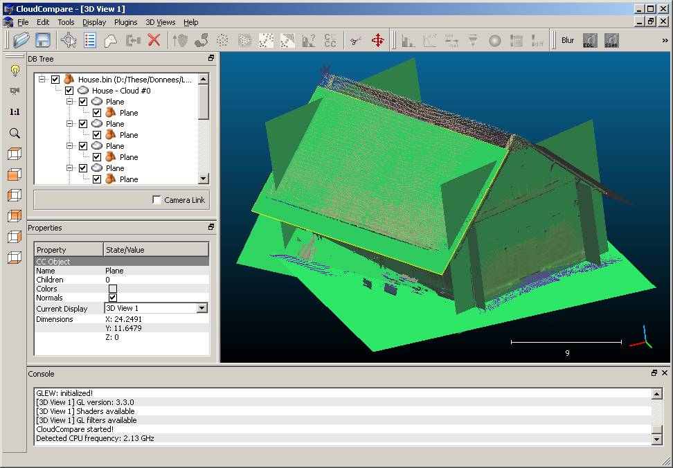

Re: Plugins
It's already available in the Visual 2008 version. For this, you just have to download the sources, and launch the project with the 'start_visual.bat' file (XP) or 'start_visual_x64.bat' (Vista/Seven 64 bits) in the 'trunk\qCC\msvc\VC9' folder. You'll also need a Visual compatible version of Qt and the Qt Visual Addin for MSVC 2008.
It is almost fully operative : it segments the cloud as Schnabel's library outputs, and it is alerady able to associate planar and cylindrical parts with the corresponding mesh primitive. The other primitives should be easy to add to CloudCompare (cone, torus and sphere).
However, the big issue is the compilation with MinGW ...
Daniel
qRansacSD plugiin output (planes only)
