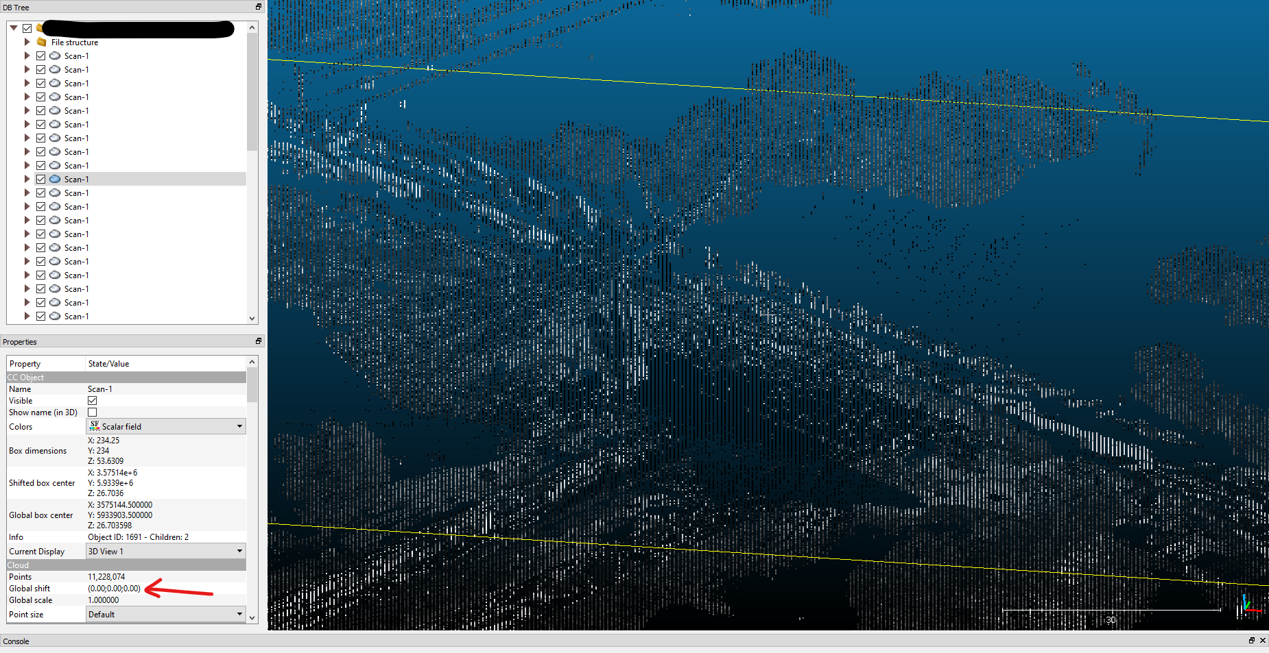

I mentioned before that I can see the pointclouds now. The thing with them is, even though their global shift is 0, they look like I haven't applied the global shift to remove the global coordinates. When opening a pointcloud with huge coordinates they look like the points are falling into a ordering grid, because of the lost precision, right? The same is happening here with these clouds, even though they were shifted.
Attached a screenshot of CC
Yeah, I'm completely sure. I tried saving the new E57 by selecting all the shifted clouds and also by selecting the parent folder, but I get the same result.
- Global Shift.png (423.56 KiB) Viewed 13970 times

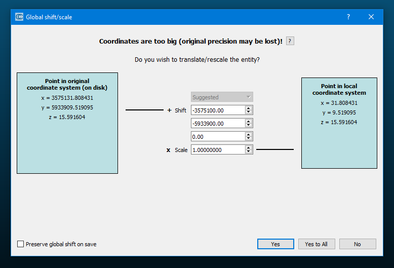

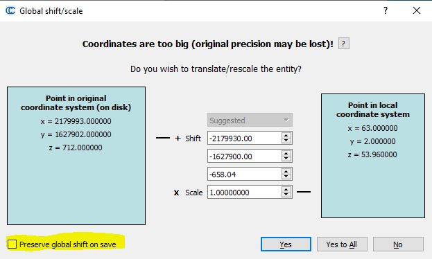

What does the Global Shift dialog look like when you validate it?
On my side it looks like that:
Re: Remove global coordinates from pointclouds
I'd say on my side it looks the same:
- CCdialog.png (24.93 KiB) Viewed 13831 times

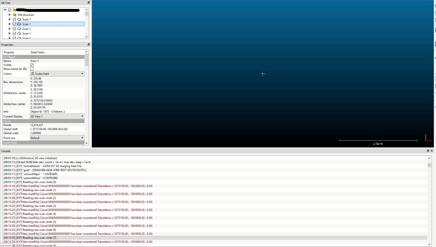

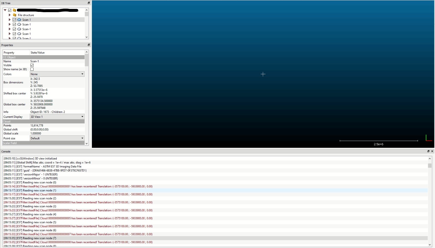

This is what I get if I click "Yes to all" in the previous dialog. (CC1.jpg: First pointcloud / CC2.jpg: Second and the rest) (if I click on "yes to all" the clouds are not visible because apparently the first cloud is moved, the rest stay behind, so there's a zoom-out applied)
Yup.
- CC2.jpg (176.72 KiB) Viewed 13667 times
- CC1.jpg (175.34 KiB) Viewed 13667 times
