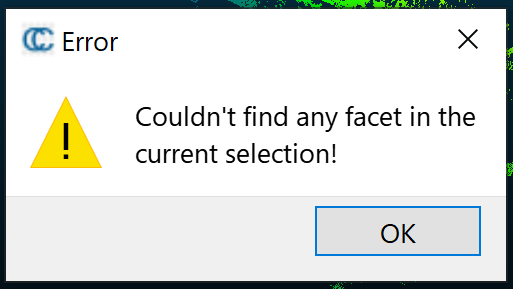

2. I am most interested in Z axis - therefor I want to use the "split x, y, ...". Is there a way of exporting this data of distances of each point to her reference point in a CSV file? when I try to press the CSV button I get the attached error message.

- error.PNG (15.19 KiB) Viewed 8030 times

2. You can export the cloud (with its distance scalar fields) as an ASCII file. Setting the export parameters correctly, it can correspond to a nice CSV file, with the distances in separate columns.

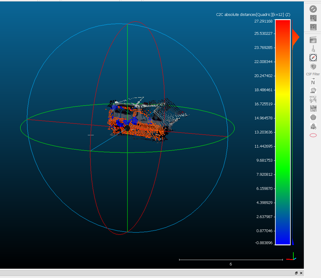

Generally I am trying to compare my generated point cloud to a point clout exported from a Lidar sensor (my reference).
The parameter that interests me mostly is the "distance" to objects (Automotive field) therefor I thought looking at Z axis will be as close to what I am looking for.
My PC is much denser than the reference PC therefor I user "local modeling", "Quadric",
1. Should I use the default radius?
2. Looking at the results in "C2C absolute distance (Z) meaning - the distance between each point to her reference in Z axis? (because the numbers do not match what is seen with the human eye - see attachment)

- 2020-09-30 16_30_51-Films & TV.png (80.62 KiB) Viewed 7859 times
Re: Cloud-to-Cloud Distance
1. Maybe not, the default value is really a default one, base don the cloud bounding-box. Depending on your density you may have to increase or decrease it (hard to tell just by looking at this snapshot).
2. That's the Z component of the vector between the 2 points: the point from the compared cloud, and it's nearest point in the other PC. Which is not necessarily the nearest point along Z! The C2C distance algorithm is quite "simple". Maybe using M3C2 would help here (you can look for the nearest points along normal directions, hence you can control this direction by tweaking your normals, or choosing purely vertical or horizontal normals, etc. - rotating the clouds might help as well).
3. In this case it would be more the points for which it was not possible to compute a local model (i.e. the radius was too small)
4. It will be in the same units as your cloud coordinates (units are sadly never saved in most PC files)
