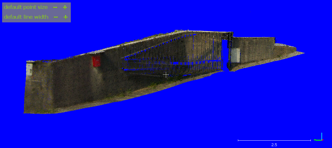

I'm trying to draw the cross section of a retaining wall scanned using a laser scanner (the one that you can see in the "screen_1" attached).

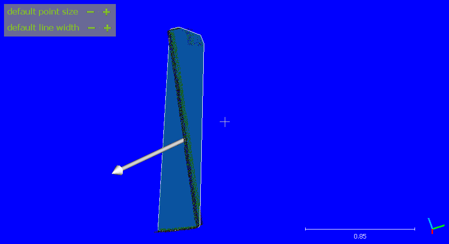

From the entire points cloud I cut out a smal portion rapresenting the transversal section of the wall that I need to retrace (see the "screen_2" attached).
I just want to reproduce the wall in sketchup pro 2020, are there plugins that can help me?
Right now the only method that i found is to create a polyline using Extract Section command and than import it in sketchup.
The problem is that I need to change coordinate system and makes it perpendicular to the plane containing the section of the wall in order to correctly draw the polyline.
So, is there a way to change coordinate system and makes it paralel to the normal vector of a plane (see the "screen_2" attached).
So that I can draw a polyline on the plane that I have create using Extract Section (in Segmentation tool).

Indirectly yes: if you right click on the plane (in the DB tree) and choose 'Align camera', you'll see in the Console the 'matrix ' that makes the plane parallel to the screen. You can the copy this matrix and paste it in the 'Edit > Apply transformation' tool (select your cloud first).
This will rotate the cloud so that the plane normal vector is parallel to Z.
