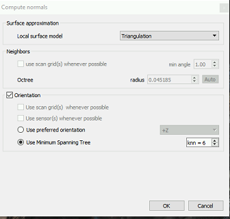

I find myself needing to make meshes from car interiors a lot. First, I compute the normals. Here are the settings I use for that:

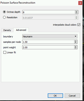

Then I do Poisson Reconstruction:

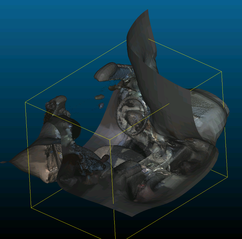

Then, the mesh that comes out always has these giant surfaces:
I have to go into Meshlab to cut these out and it becomes time consuming. I have played with the parameters for normals and Poisson Reconstruction to try and eliminate these but to no success. Is there a parameter I should be focusing on?

Have you read the part about the 'Density' output (first tab) of the PoissonRecon plugin dialog?
You should activate this option. This will add a scalar field to the mesh that lets you 'segment' the mesh interactively based on the density of the Poisson reconstruction (which more or less depends on how far the mesh triangles are from the cloud). This is super efficient to trim the mesh parts that are far from the cloud (and generally inaccurate).
