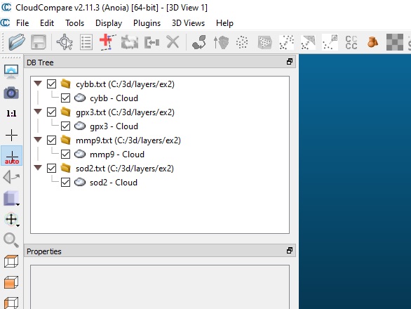

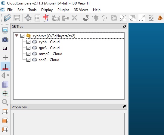

Long: I have point clouds with points ranging from 200k to 2mil. The points are differentiated from each other via coordinates (duh) and colors (max 100). The colors represent something specific, they are not for just visual representation, so I need them. What I can do right now is manually export each color specific point cloud in a txt file and import them all with Ctrl + A in CC. The thing is that each point cloud creates its own "folder" structure in CC (see 1st image - simplified to 4 clouds). After a little bit of tinkering and moving stuff around I can arrange them as I would like them to have (see 2nd pic).
The reason for this arrangement is that I need to be able to easily select/deselect layers/clouds. It needs to be easy because I will have clouds with roughly 100 layers which I need to select/deselect (subsequently becoming visible or not). "My" limitation is that I have to work with txt point clouds because that's my source. I know that .e57 files have this structure in them but I cannot generate this format.
Coming back to the beginning - it would be great if I could import the layers in one go as a zip file and they stack each other as the 2nd pic.

- 2nd.jpg (52.19 KiB) Viewed 6379 times
- 1st.jpg (59.34 KiB) Viewed 6379 times
