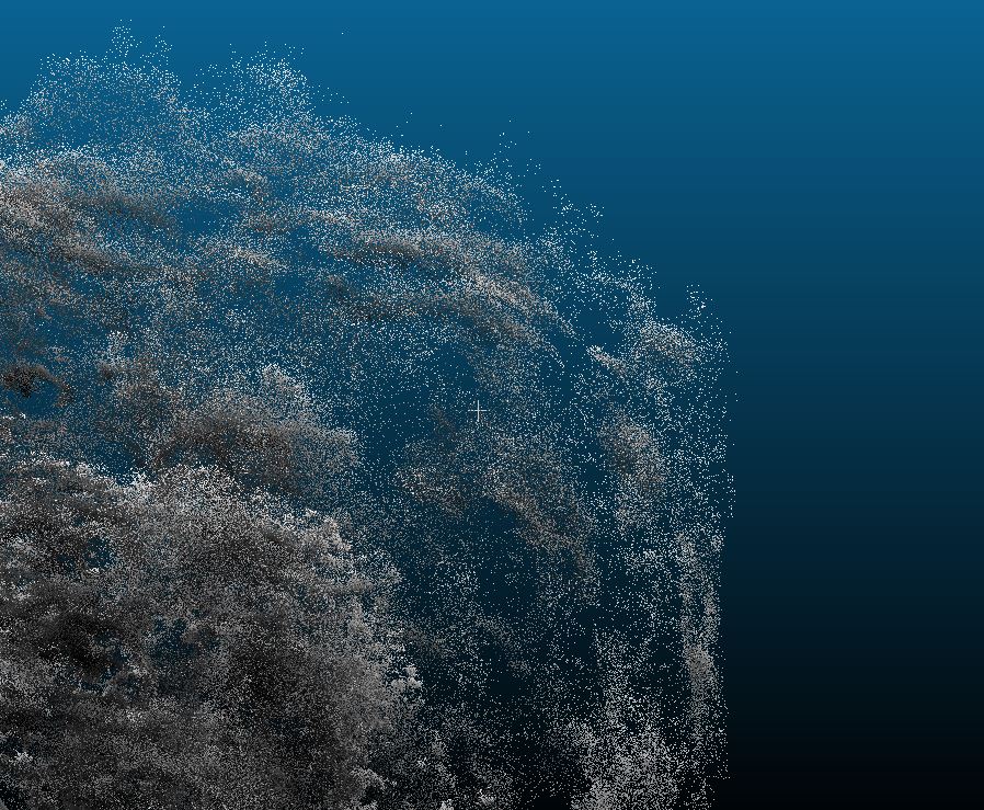

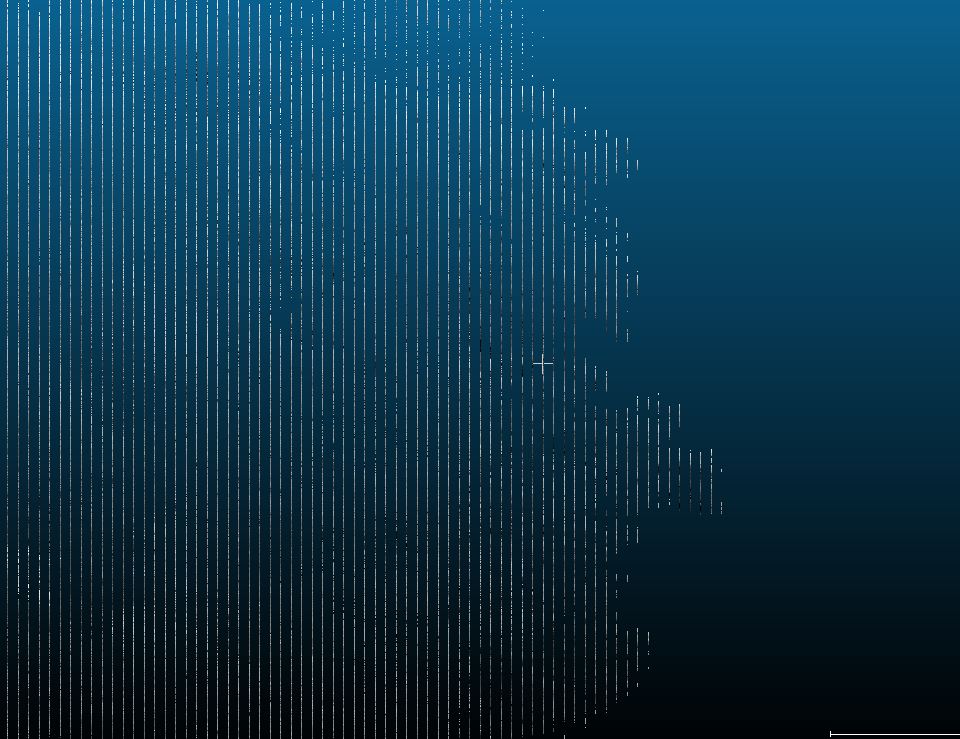

Sorry, I am new in CC. I tried to align the cloud to Hong Kong 1980 Grid. The cloud is right in place finally. But the view become very strange afterward (see attached files). Would anyone can help? Many thanks!!!!!!!
- before aligned.JPG (210.57 KiB) Viewed 4503 times
- after aligned.JPG (129.73 KiB) Viewed 4503 times

This is due to the large coordinates. Has CloudCompare ever suggested to apply a (temporary) Global Shift during this process? If yes, then you must accept (otherwise you'll lose accuracy). And if not, I would be interested to know the steps you followed to reach this state?

Hum, normally it should have prompted you about applying a Global Shift if the coordinates were too large...
If not, would you mind sending me the coordinates and maybe the cloud? (or at least a super subsampled version of it). My email is 'admin [at] cloudcompare.org'

It may have prompted me at the first time. I wrongly chose "No" at that time. and no more prompt now. How can I activate that prompt again?

The coordinates are 836000E, 828000N. I am now just shift it to 36000E, 28000N and apply a insert point 800000E, 800000N in Rhino in short run.

Well, when you restart CC, it should definitely ask you again.
