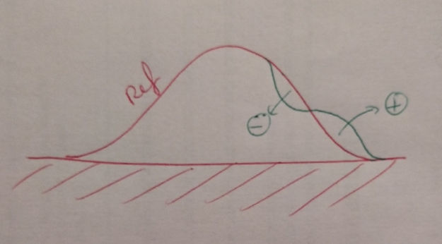

I'm working on the comparaison between two clouds for cubature.
I'd like to know where i've lost or gain material. I succeed to analyse with C2C Absolute values but i'd like to know in negative and positive and not only in positive.
Do you have a solution ?
Merci.
Re: COMPARAISON BETWEEN TWO CLOUDS
So C2C is not ideal to do that as it only outputs unsigned distances.
You should look at other tools:
- M3C2 which is a little bit more complicated, but gives signed distances
- C2M (if you can have a mesh version of the reference cloud) that also gives signed distances
- 2.5D Volume Calculation tool
