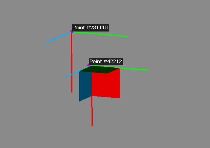

So actually you can do both of these (sort of).
for the point index label, use the point picking tool, select a single point and create a 2d label, then select the label in the DB tree and turn off "Show 2D label" and turn on "Show legend(s)"
for the coordinate display you can use the "CoordinateSystem" primitive with the translation vector set the same as the point coordinates. (you will need to decide orientation with some more information like Daniel said)
Here is an example of following those instructions, on one of the CoordinateSystems I turned off plane display
But this is a fair amount of effort per point so it would not be optimal to do this by hand for a large qty of points.

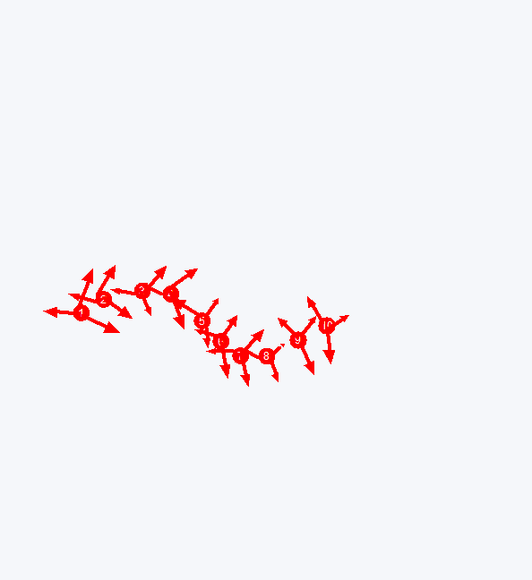

Re: Can cc display the coordinates of each point? Can cc display video?
Thank you all for your advice,
I did this with pcl.
