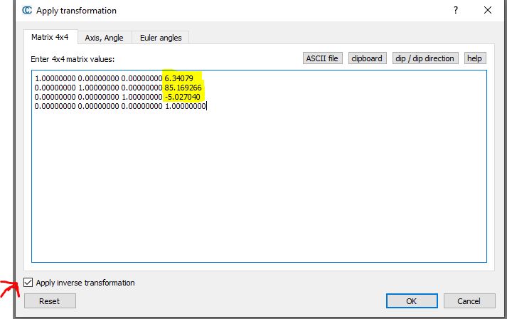

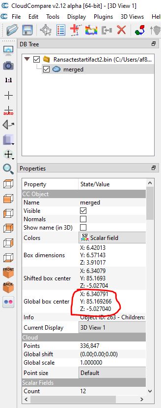

Post by WargodHernandez »
just apply the inverse transform of your global box center
