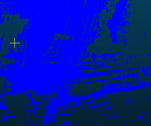

I did my job of getting coordinates in onitemoicked, but I ran into a problem.
When I adjust the scalar, click on my plug-in to select the mouse point function, an exception occurs, the point cloud color disappears! The scalar is still the one I set. When I set the scalar again, the scalar will not be abnormal again.

we would need a lot more context to help track down the exception, what your showing has a risk that it would try to use an invalid picking hub since your valid picking hub check doesn't bail out of the function early.
but beyond that, we need information.
Re: getPickedPoints
Thank you for your answer, we solved this problem, and we found that on the first click, cc created a scalar called "octree_picking" for the point cloud.
