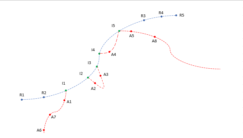

I'm using Cloud Compare to calculate the distance (thickness) between two point clouds, but seem it has an issue when these point clouds have an intersection.
For example, the referenced cloud has points R1, R1, R3, R4, R5, R6, R7, R8, R9, R10, I1, I2, I3, I4, I5.
and the computed cloud has points A1, A2, A3, A4, A5, A6, A7, A8, A9, A10, I1, I2, I3, I4, I5.
in which I1, I2, I3, I4, I5 are the points on the intersection of two point clouds.

for example the nearest neighbor point of A1 is I1, A2 is I2, A3 is I3, A4 is I4 and A5 is I5, but I1, I2, I3, I4, I5 are on the same computed cloud.
Is it right? When calculating distance between two point clouds does it eliminate the nearest neighbor points on the intersection?

I attach an image to illustrate about this case.
You can see I1, I2, I3, I4, I5 are intersected points (lie on both referenced point cloud and computed point cloud).
In that case does it eliminate the nearest neighbor points that lie on computed point cloud?
(The expected result of nearest neighbor points maybe A1->R2, A2->R2, A3->R2, A4->R3, A5->R3)

Ah no, the 'nearest neighbor distance' is very simple, and each point is processed independently from the others. So in your example, A1 will be probably closer to I1, thus its distance will be A1I1.
