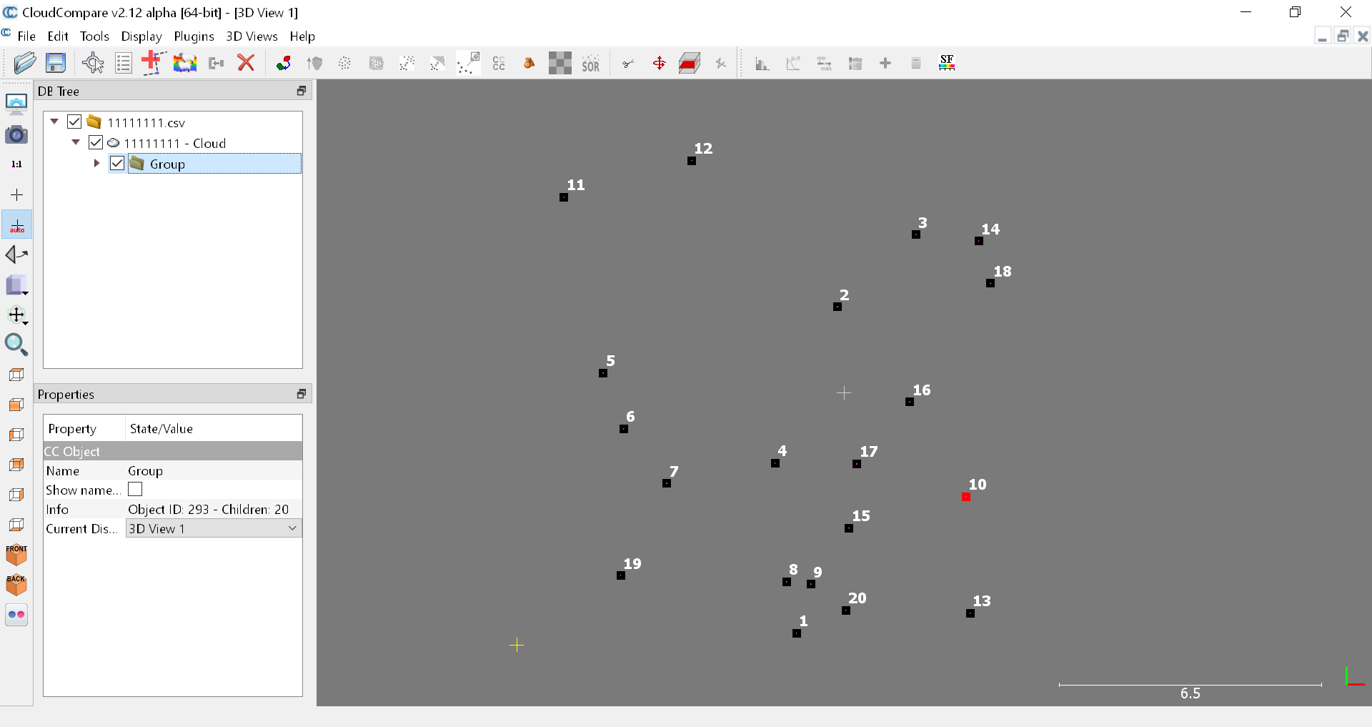

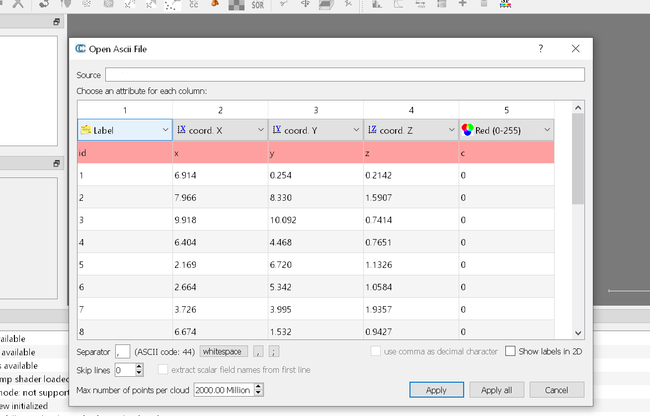

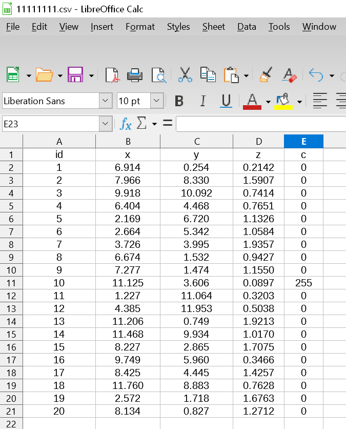

1- Use text editor or LibreOffice Calc to add 255 in front of your red points and 0 for others
2- Save as csv or txt
3- Open by CC as in pic below
However may be there is beter way directly by CC ?
Remarks:
1- You can ignore label during importing points
2- You can put labels in group to show or hide
3- You can change opacity of label to 0
4- To change points size use properties not (+- ) it is sometimes does not work
