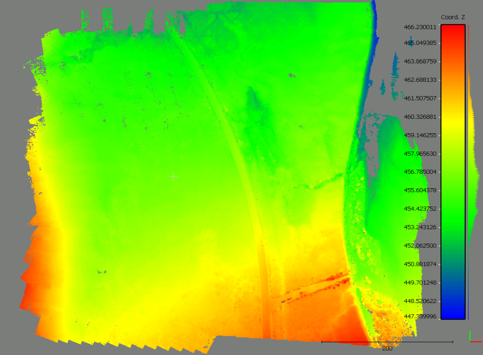

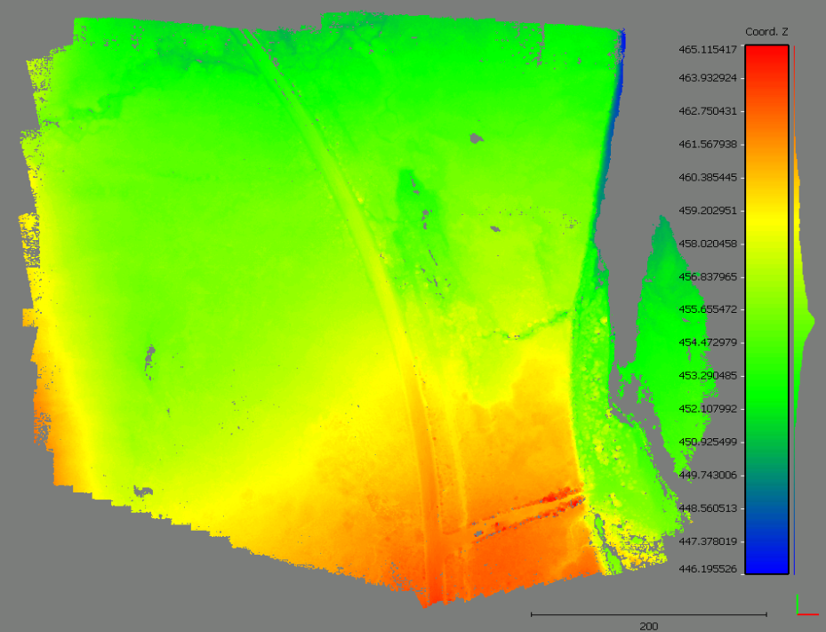

1) I generated the point cloud with OpenDroneMap which displayed a massive vertical offset, that I fixed using ICP alignment (with no segmentation beforehand) in CC: final RMS 1.06. You can see the resulting point clouds below, z value displayed.

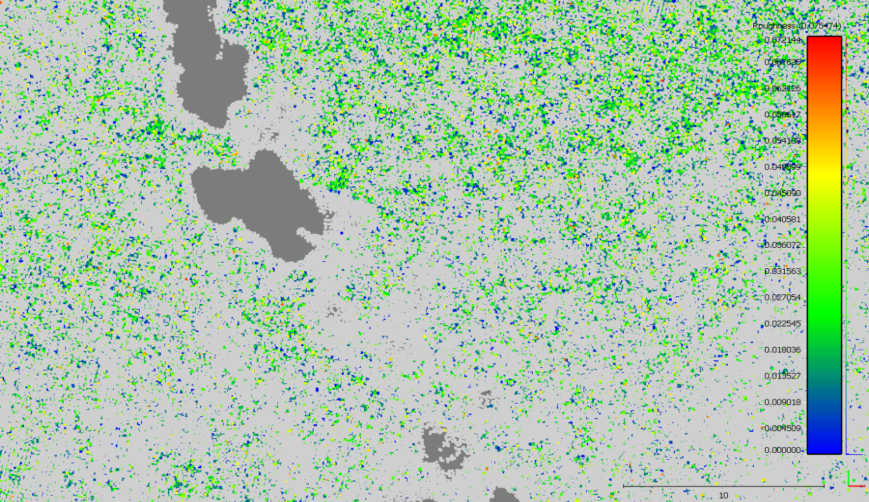

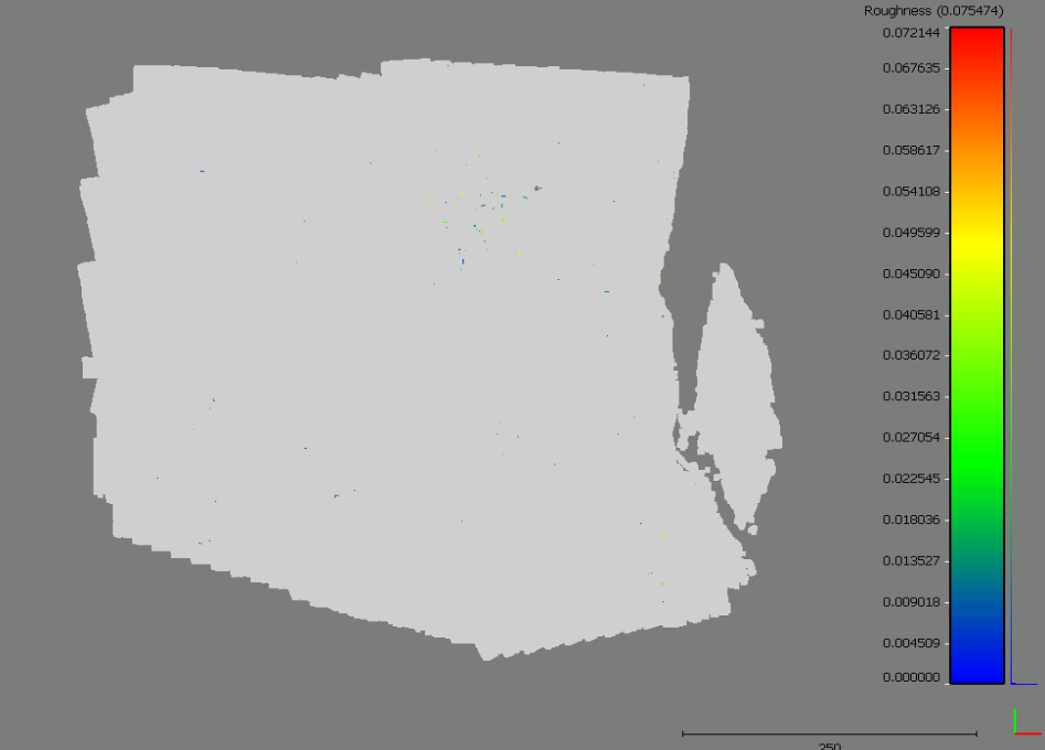

2) In the Lague paper it is mentioned that I should set the Normal scale (D) to a value that is at least 25x roughness of the point cloud. The figure below depicts the roughness I calculated on cloud#1. While the overview depicts nothing but grey values (no roughness?!), a zoom in reveals values mostly ranging between 0.02 and 0.3, which would call for a Normals value of 0.5 to 0.75. When I use "guess parameters" the program however repeatedly gives an output of 1.17 normals diameter and 0.59 projection diameter.

A) Regarding your second point (2), it's obvious that the radius you used to compute the roughness it way too small (grey color means that there was not enough points around each point to compute the roughness). You have to compute the roughness on a bigger radius (until almost all points have a roughness value).

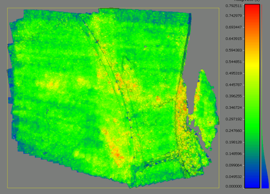

A) increased the roughness radius to 1.0 with the following output
What is remarkable, however, is that the point cloud itself seems to be "layered": when the cloud renders it first presents points with a roughness value of up to 0.09 (blue colours, also see the histogram next to the colour bar). The points "on top" of that layer, however, show values of 0.3 to 0.6 (green to orange). Could my cloud really be that noisy? I wanted the cloud to remain as raw as possible, but maybe it is more helpful to apply a noise filter beforehand? Once again here I have the problem of defining a radius. I guessed the value 1.0, but that is rather unscientific. How can I estimate a good radius value for both calculating the roughness and applying the noise filter?

Well, either it's noisy, or it's due to the laser penetration in the vegetation?
