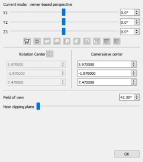

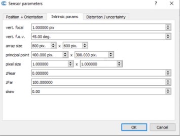

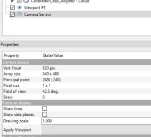

The first question I have is about the field of view value (see attachment FOV.jpg). I have set up this camera to have a FOV of 42.3 deg. Is this the horizontal, vertical, or diagonal FOV? On the options you indicate vertical (see attachment FOV_Options.jpg). This doesn't seem to reconcile with what I have in another program that also uses virtual cameras. What about the FOV when adjusting the current camera? (see attachment FOV_camera.jpg) If I remember correctly, through trial and error, I found that this was the diagonal FOV.

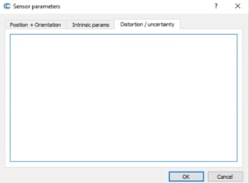

Finally, is there any way to bring in distortion, or is this for future use? (see attachment distortion.jpg)

Normally it should be horizontal FOV (we deduce the width of the viewport from the f.o.v. and the distance to the camera optical center).
And since OpenGL is doing most of the work, I'm not sure how you could apply the distortion parameters (even if it's probably technically possible).
