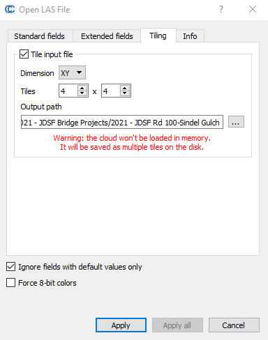

Has anyone experienced any troubles importing a LiDAR file (LAZ) into CC and only getting one tile. I selected the 4x4 on the Tile tab but I only get one file. I've had success doing this procedure before, but for some reason it's not working with this dataset.
Any suggestions?

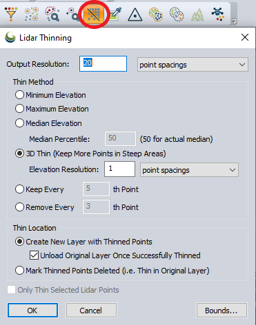

I believe I found the error in my way. The file size was way too big to tile. I was able to use Global Mapper to reduce the file size to a more manageable file size for CC and it was then able to tile.
2,509,417,907 Original
708,160,387 x20 reduction
333,156,473 x20 reduction of the x20 reduction (This file size works in CC)
