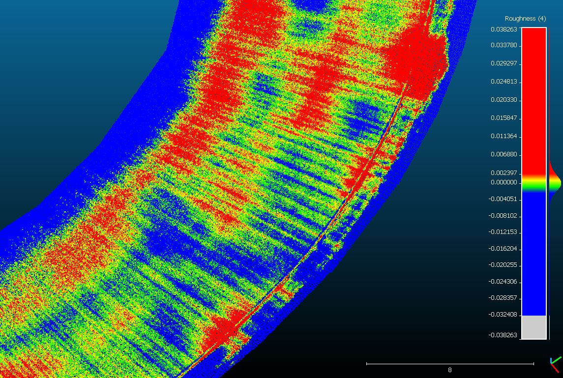

Here's what the prototype looks like (with a radius of 4):

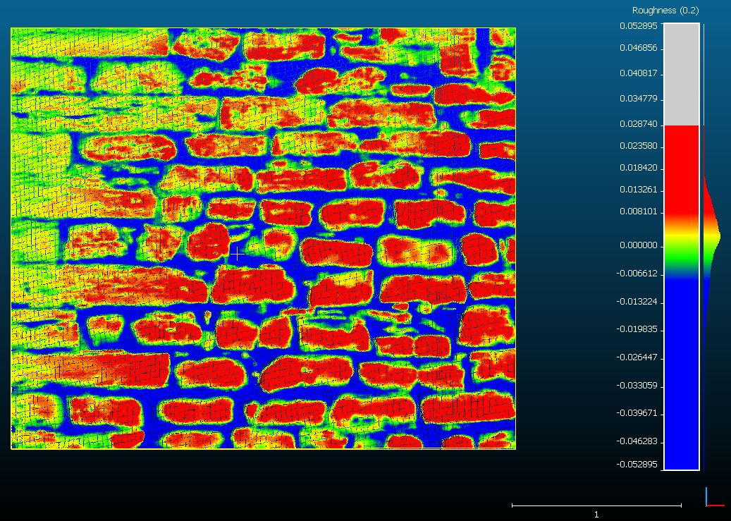

Here's another example:
